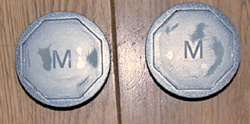

The centre caps of the MG's wheels are pretty faded so I decided to change the badges to spruce them up.
It's not rocket science, but it really does brighten up the wheels.
The badges are 44mm octagons and the originals are metal; glued into a recess in the centre cap itself.
To remove the old badge you need to insert a slim screwdriver or knife into the gap between the edge of the badge and the recess.
By carefully sliding the tool under the badge you can ease it away from the cap.
Once the badge has been removed, you will need to remove the remains of the adhesive from the recess. I used an abrasive paper and cleaned up with white spirit. Fortunately, the caps themselves were in good condition and once cleaned were ready for the new badges.
As`you can see from above, for some reason there is a raised letter 'M' in the recess. I rubbed that flat as well as removing the glue and roughening the area to take the new adhesive.
