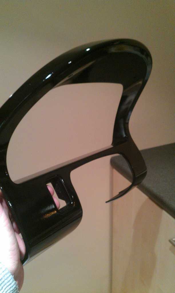

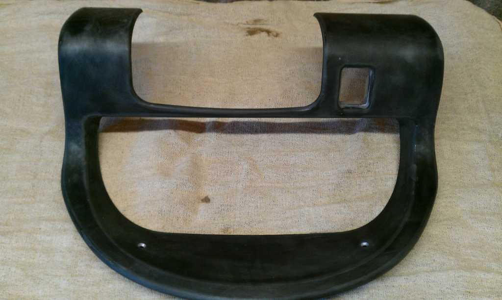

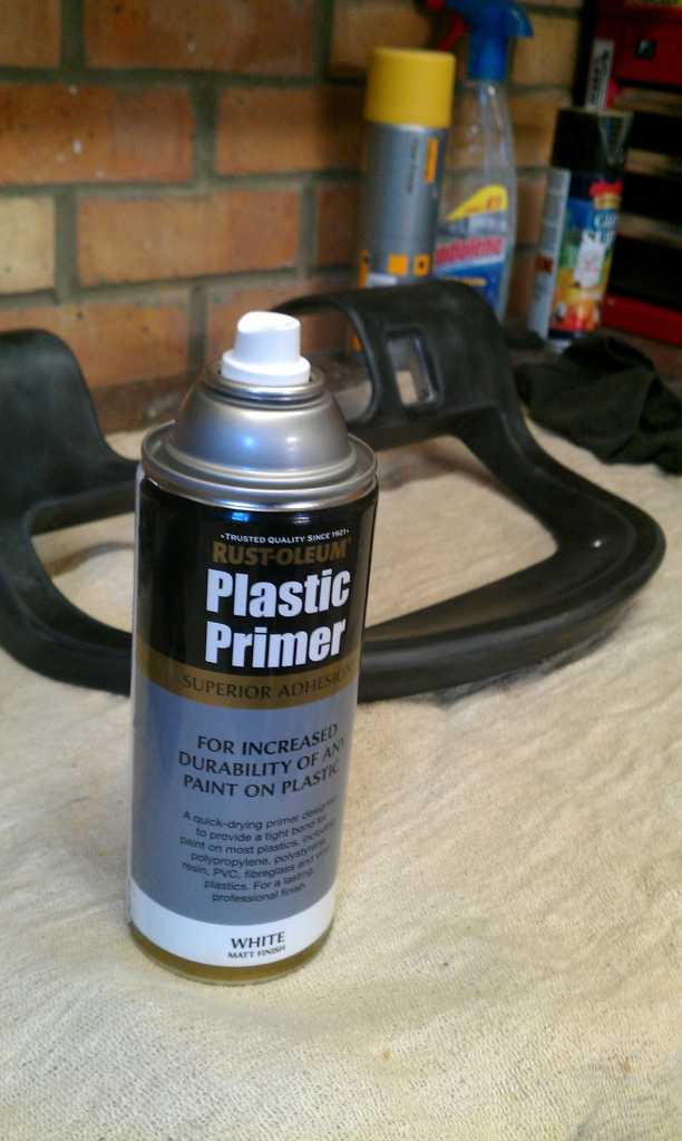

right my car is still at the sprayers and not due back till feb so i thought ill give the dash bits a paint.thay had a snake skin effect on them that was all crack so heres my how to.

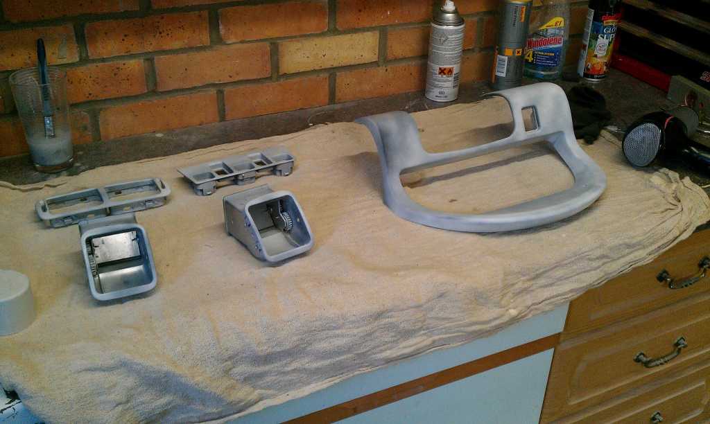

first i give them a good sand with 240 wet & dry
then i give them i good clean with a damp cloth
i use a hair dryer to dry them (you my need permision)
use the hair dryer to get them warm ready for primer

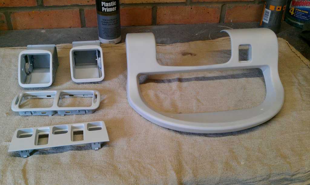

i used this plastic primer from b&q really good stuff a lite coat first
give them 3 coats use the hair dryer between coats. after i put them in the airing cupboard over night
next i use a inbetween coat pad to give them a lite sand all over
now thay are ready for top coat .use the dryer again to warm the plastic
just dust them over for the coat
leave for 5 mins now give them fall coat leave for 5 mins still use the dryer now give them a good wet coat
this is the finnish product

Excellent - that looks really good
by dan coupe
- bryan young
- Posts: 3635
- Thanks: 776
dan coupe wrote: Excellent - that looks really good
I agree with that, what paint did you use for the black gloss?

I got the black gloss from b&q

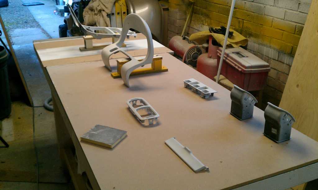

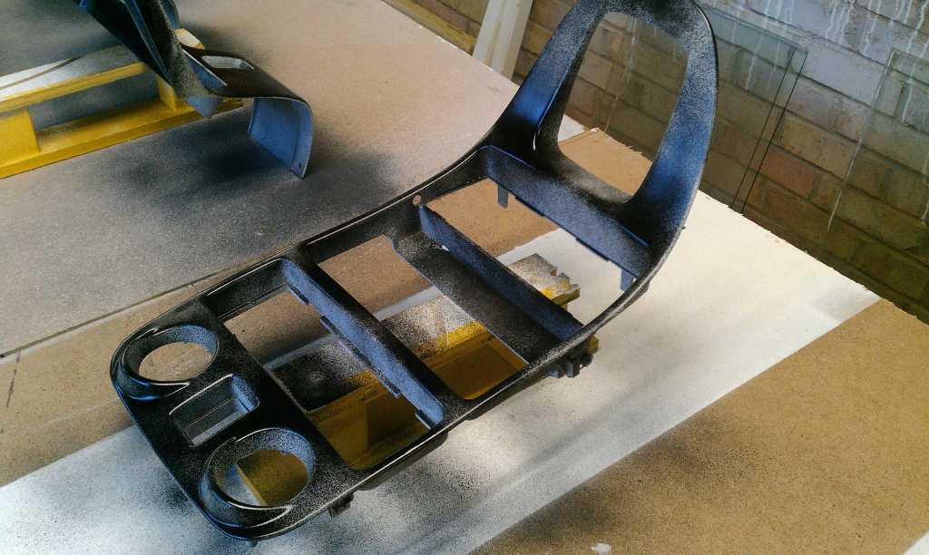

Right been waiting since october for my car to be painted & still the paint shop had not evern started it.so on wedsday I decided to do the job myself well started preparing ready for paint so here's a few pics not good ones ad the work shop that I'm renting has very por lighting but very cheap.
