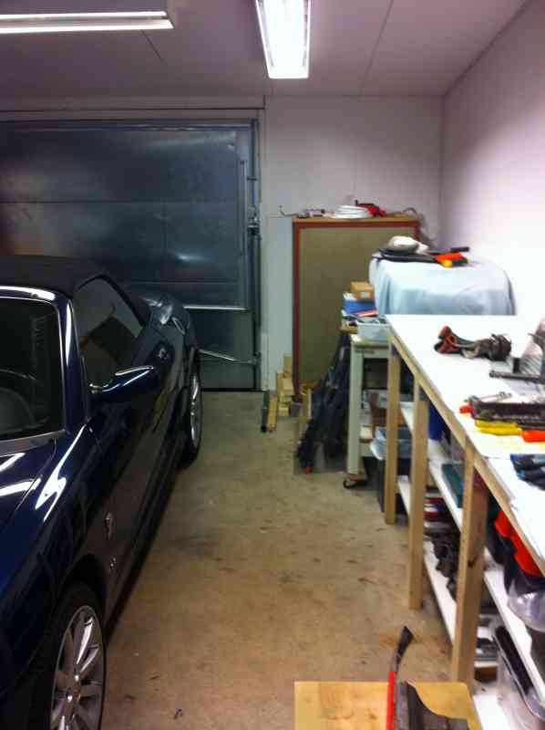

First thing on my bucket list was to fix the Blue Pearl
a proper Winter Garage. This is what we ended up with.

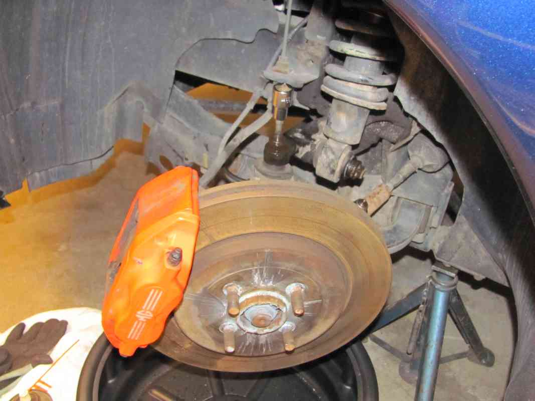

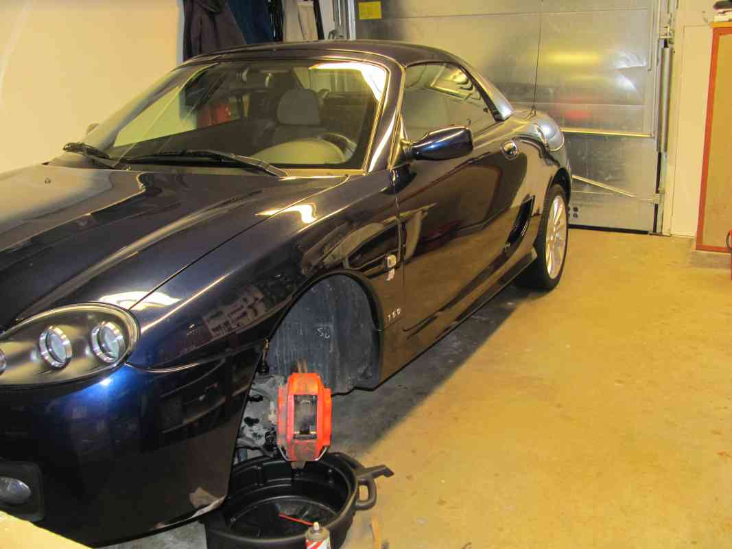

A visit to the MOT show´d that we had a exesive play
in the left lower ball joint
, so now I will have to try out
you´r how to fix it . Did a slow start this afternoon will take
a day or two to soake in the DWF from ? Castrol offcourse
I bet you couldn´t guess that right? :lol:

nice well lit workshop
The following user(s) said Thank You: Björn
Heck I am envious of the workshop ............................... I have to work on the gravel drive

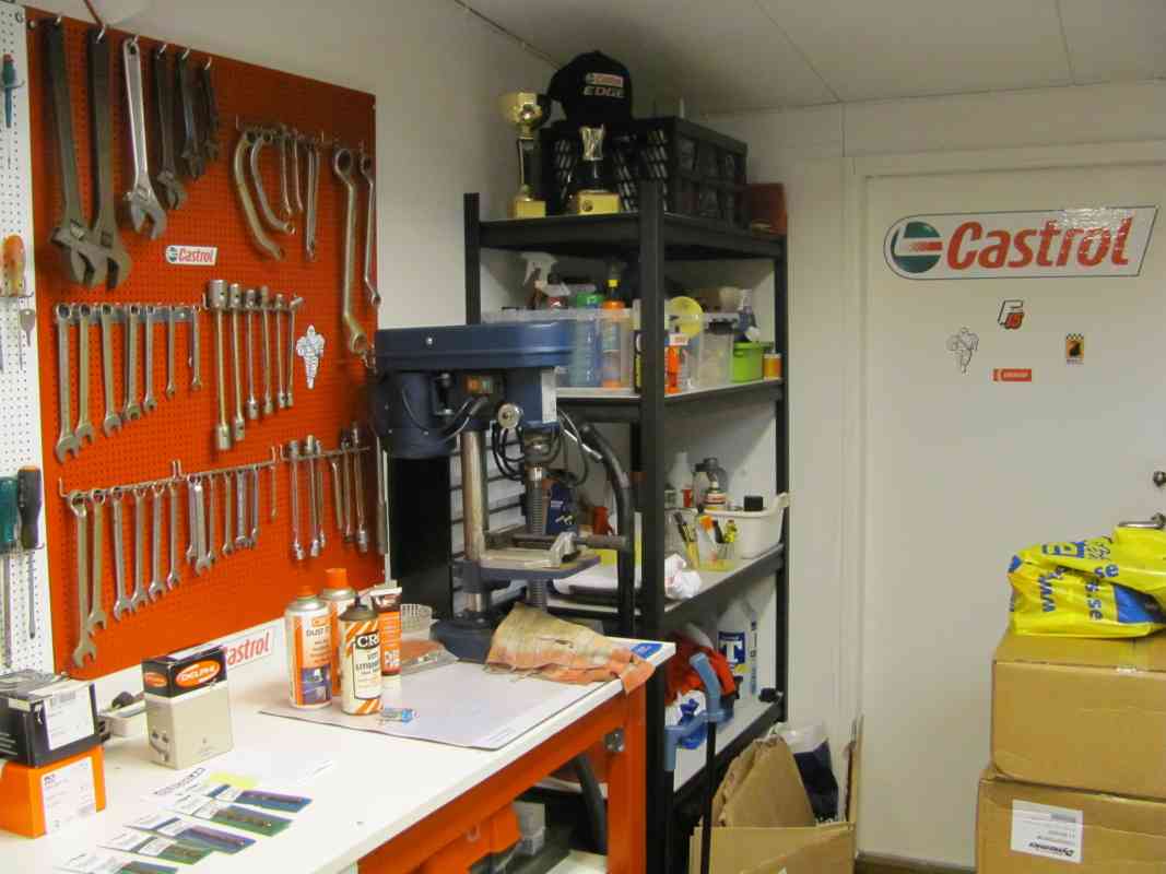

Nice setup / garage.
I see some trophies too.
Spill the beans
Spill the beans

Lets play through the keyhole..........we know your bjorn..................do you work for castrol?

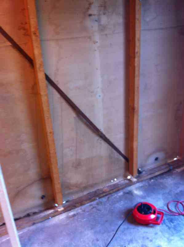

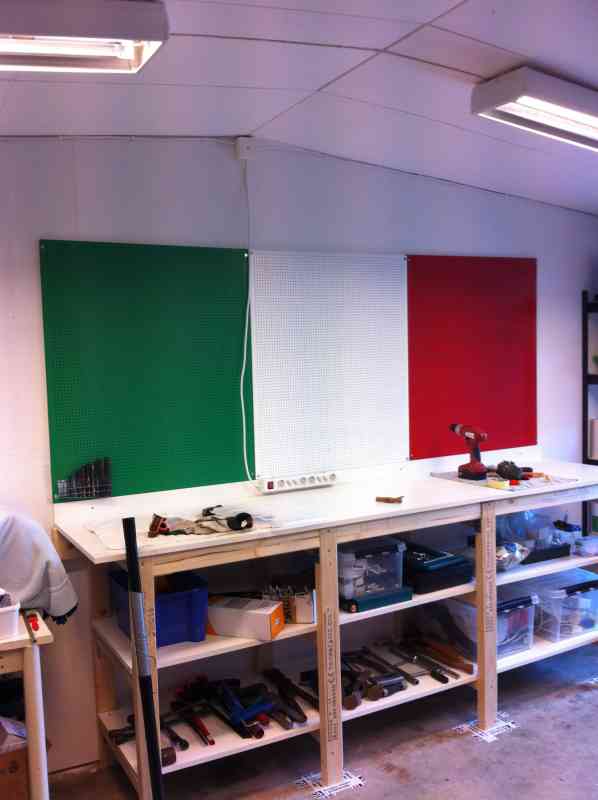

Hi All
LOL no I don´t work for Castrol and those Trophies are some
old R/C Cars from way back. Found them going through a lot off
old stuff this Summer when I renovate the garage to a Proper MG
garage for the Blue Pearl.

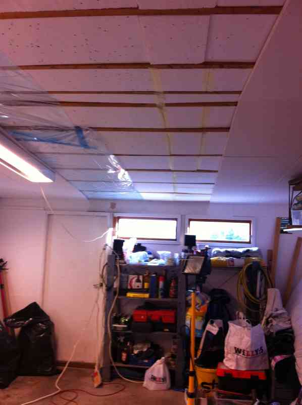

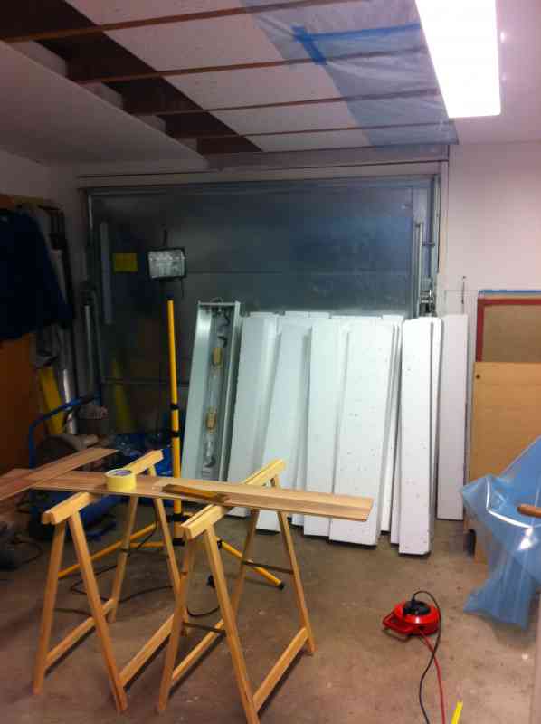

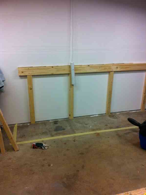

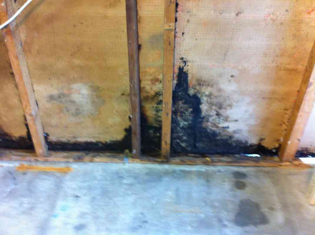

Not long ago it looked like hell over here. :bang:

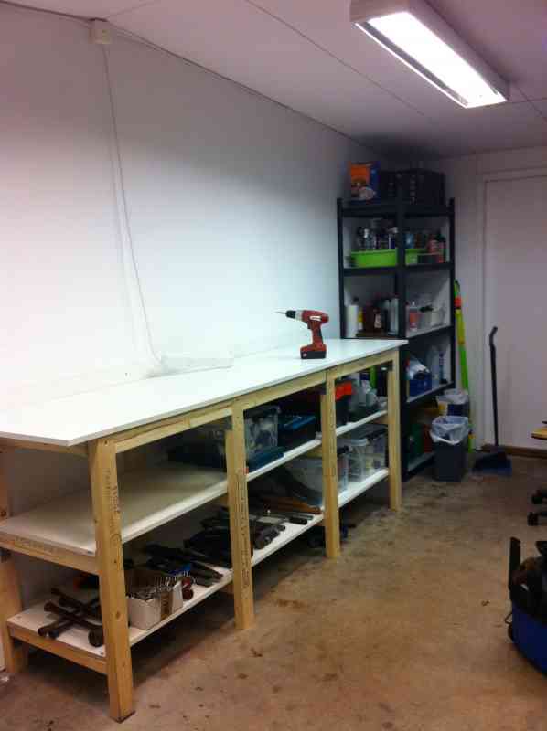

So enjoy three months work in a couple off pictures,

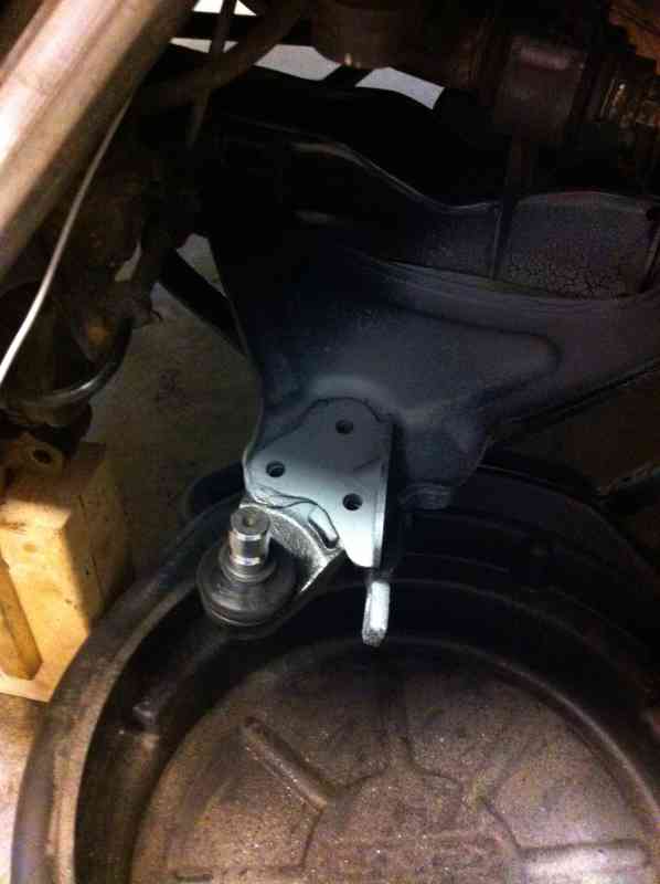

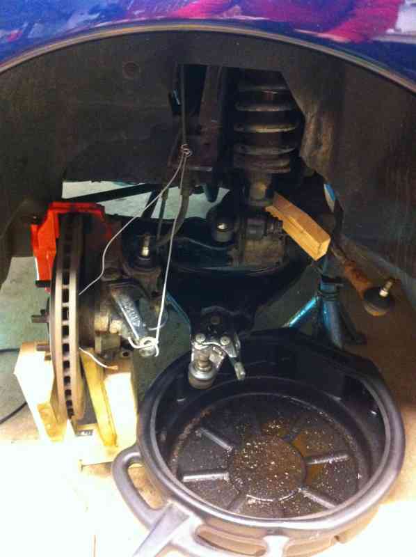

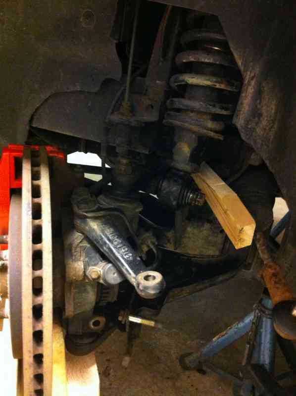

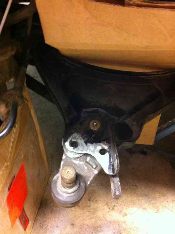

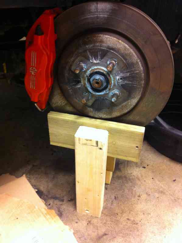

Well enough about the garage, after a good read through on
how to go about the Lower ball joint.. I took some left over from the
renovation and made a simple jig for the front hub. Not to stress the
brake hose or the ABS sensor cable.
When I had it off the lower/upper ball joints.
That sure took a while to get the lower off though.
Primed and ready for the bolts.

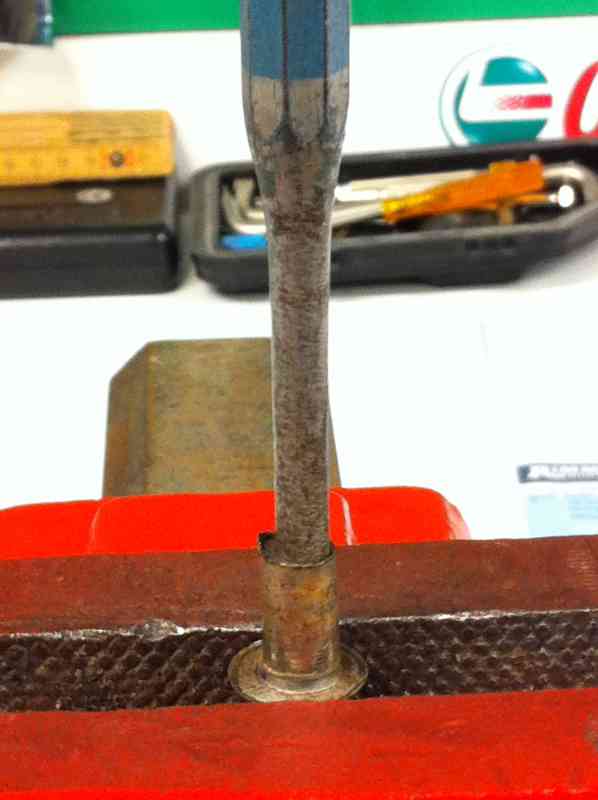

I didn´t drilled my rivets trough just a 15-20 mm down
made it a good jig for the punch? Not sure its the right word for it
