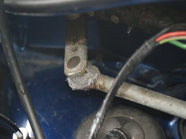

The drivers side just parked itself in an upright position. I thought, bless her, she just wants more attention from me.
David Aikegate helped out with is reply;
I've just repaired ours after it did the very same thing, doh.
I got the uprated system from Mike Satur. You can drill through the ball joint and fit a nut and bolt, or temporarily use a hot soldering iron to melt the palstic cup around the ball.
It was the hot bit of David's reply which got me thinking.
I cleaned up the end of the arm with the socket on, then using a silicone spray carefully coated the ball at the end of the the other arm and reassembled the wiper mechanism.
I then used a hot glue gun to apply glue generously to the assembled joint.
The silicone coating on the ball stopped the glue adhering to to the ball but allowed it to form around it and all over the socket end to make a plastic housing which has, to date, kept everything in place.
It has had quite a lot of use over the past weeks and on inspecting it today the whole arrangement is very secure and works perfectly. It looks a bit crude but to be honest in the normal parked position you don't actually see it.
Obviously only time will tell but the fix was done in five mins and in principle should stop the two arms from popping apart.

Posted 13 years 1 month ago #24509I wish I'd thought of that instead of splashing out on Mike Satur's expensive version. :thumbsup:

Posted 13 years 1 month ago #24515I was going to drill it out and put a bolt on but didn't have time as I needed to go out so thought I'd do David's 'melt the plastic cup' and then thought of the the hot gun idea.
As they say necessity is the mother of invention. I'll let you know how it's getting on, perhaps next autumn.

Posted 13 years 1 week ago #26540The wiper arm doesn't come off but I thought I would make a simple ghetto fix based on the need to reassure myself that it wouldn't just drop off with a jolt during the next storm miles from home. Here it is..
Zip ties.. :lol: carry some.

Replied by PQD44 on topic Re: Windscreen wiper failure - Quick fix
Posted 13 years 4 days ago #26704I reckon this may be worth doing just a precaution against failure in the future.

Replied by David Aiketgate on topic Re: Windscreen wiper failure - Quick fix
Posted 13 years 3 days ago #26709Excellent! Deserving of cunning plan award?PQD44 wrote: Quick update, the glue gun fix is rock solid and has kept the linkage together through the last few hundred miles in the rain.
