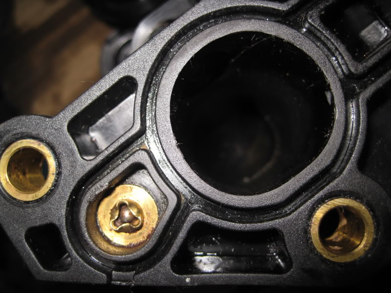

Posted 14 years 4 months ago #42246
By the way this is what caused the coolant leak in the first place - so take care with the O ring if replacing this type of thermostat
not my doing that's how it came back from the garage.
Life is its own answer, accept it and enjoy it day by day. Live as well as possible, expect no more." - Ray Bradbury, The Martian Chronicles ...
by Tigger
