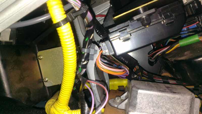

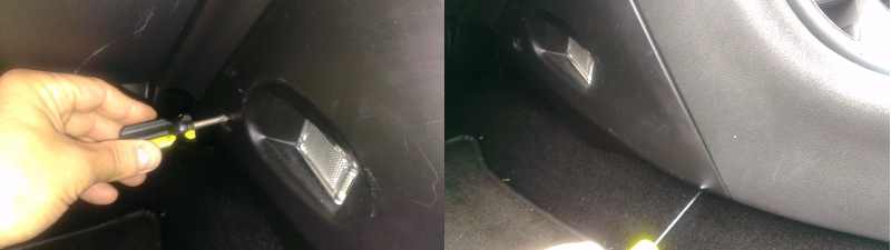

I read that if you remove the passenger foot well panel (retained by two screws),
locate the yellow aerial cable that is coiled and taped up to the main wiring loom, straighten it out and tape it you should find the operating range is increased.

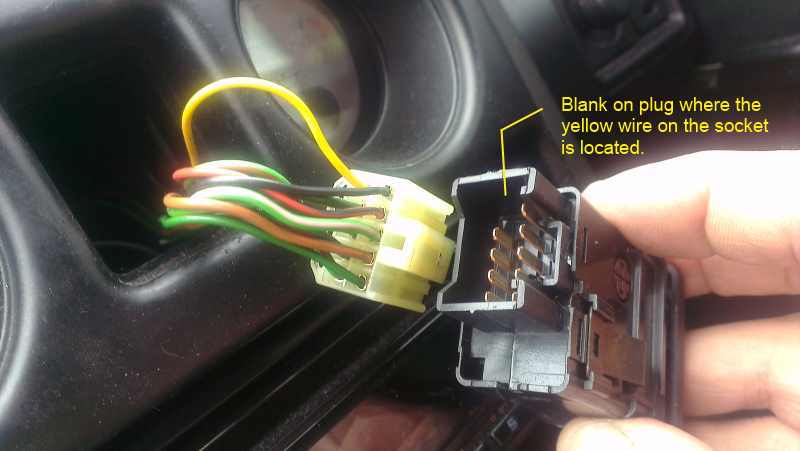

At this stage I need to say that I have a MGF MY2000 ( Mk II ). Apparently on the original MGF this was where the yellow aerial cable was located. After a bit of research I discovered that MG Rover had the ingenious idea to "cure" the range problem on the MGF MY2000 and MG TF by routing the wire to the hazard warning switch's connector block. :slapme:
So pop out the hazard warning switch and ....

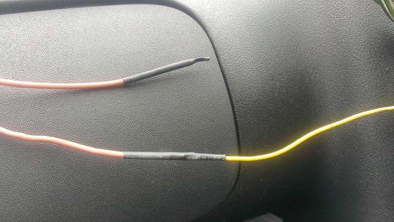

... sure enough, there is the yellow aerial cable pictured at the top left of the block. As you can see this has no corresponding connector on the Hazard warning switch. Disconnect this wire and attach a 52.5cm (see explanation below) length of insulated wire to it using a soldering iron. I then used heat shrink tubing to cover the joint and the other end of the wire (this has to be done so that the aerial wire does not touch anything metal)
The fob operates at a frequency of 433MHz in the UK which is a wavelength of approximately 70 cm, the standard aerial wire is a 1/4 wavelength or 17.5 cm. You can add 17.5 cm to create a 1/2 wavelength or 52.5 cm to create a full wavelength aerial.

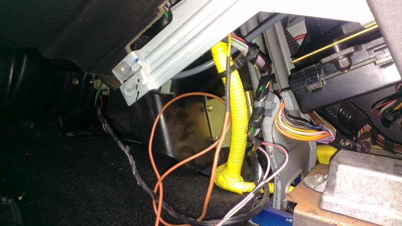

Next feed the new aerial cable down to the passenger foot well.
I then tried the aerial extended under the glove box and got a good improvement in range. I then ran the aerial along the center of the car (it ended by the side of the handbrake lever). This gave even better results and I can now operate the central locking from about twenty feet from the car :woohoo:
