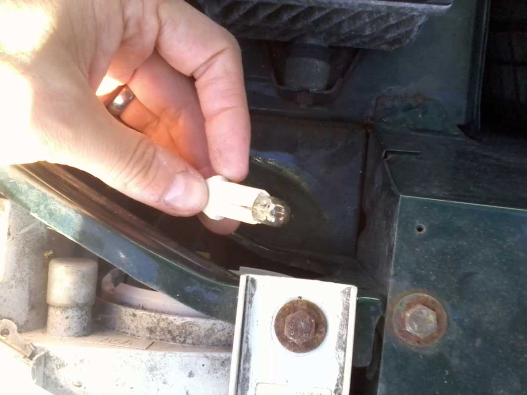

I recently changed my side lights to LED's and the only how too was for the TF. So i thought id do the F how too! It's much more simple and no tools are required.

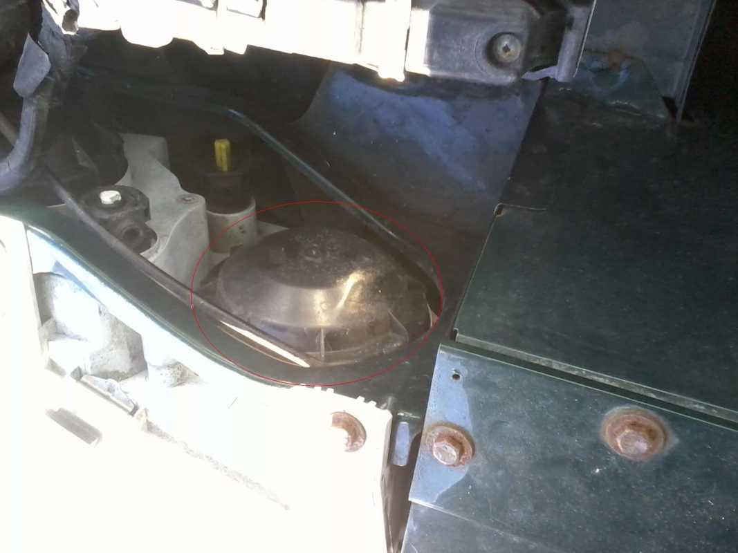

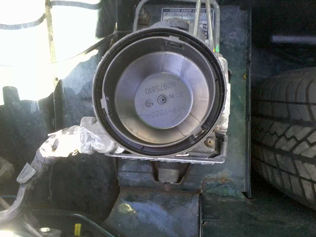

Step 1 - Open the front bonnet/spare wheel compartment.

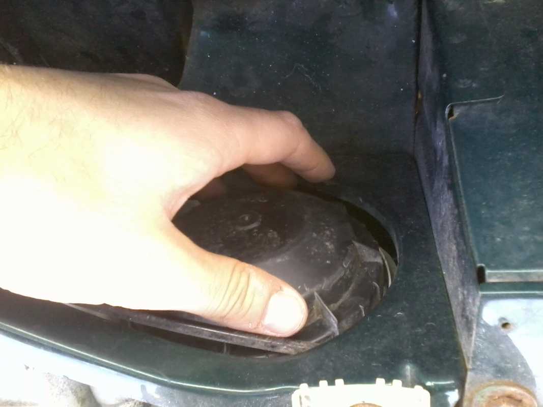

Step 2 - Identify the bulb cover and turn it to the left (Lefty Loosey).
Step 3 - Pull the cover off and place to one side.

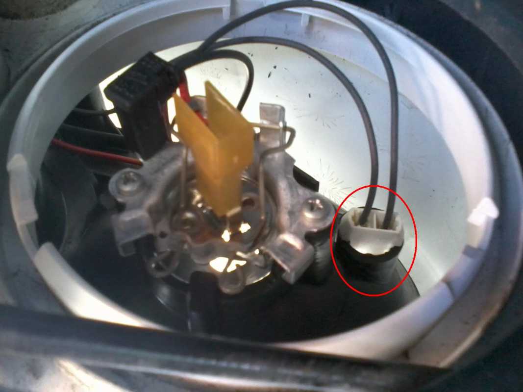

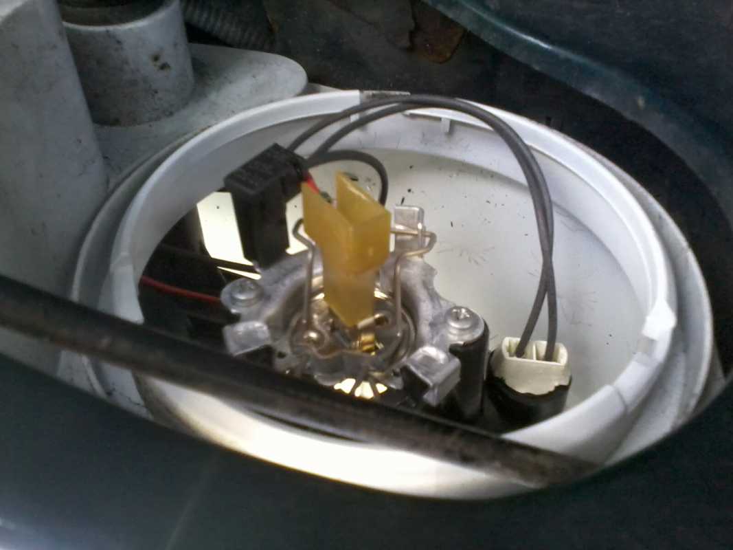

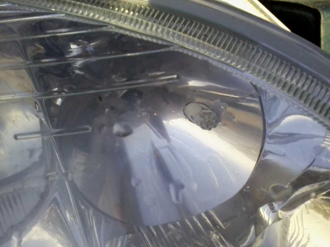

Step 4 - Identify the side light housing.
Step 5 - The side light housing is held i place by friction. Grip hold of the white portion and pull with a wiggle to free it.

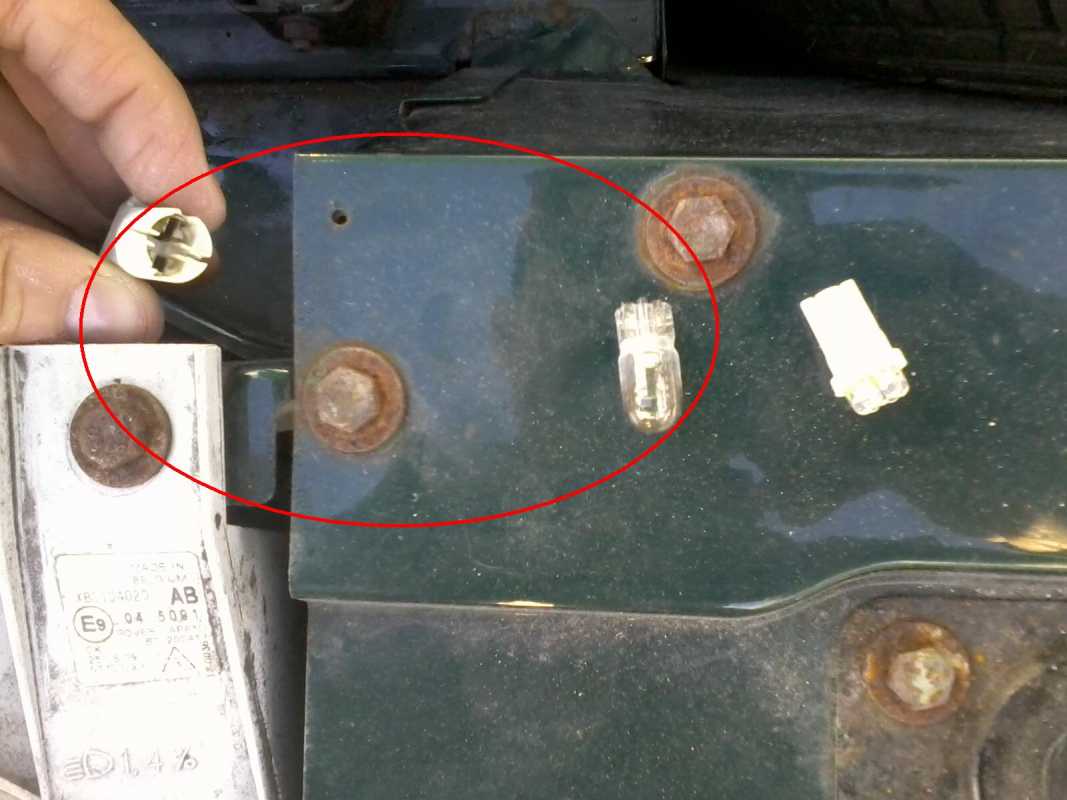

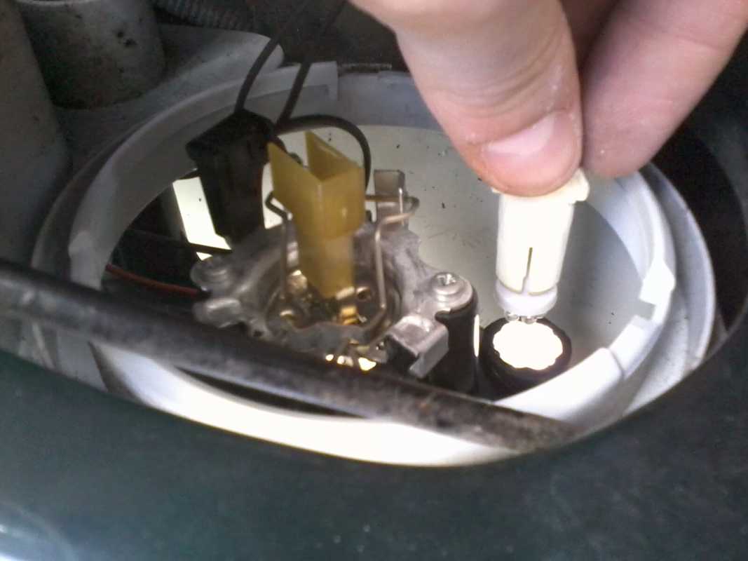

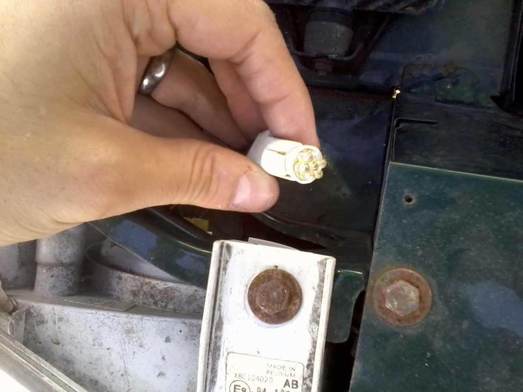

Step 6 - Remove the old bulb by simply pulling it out (the bulb is held in by friction)

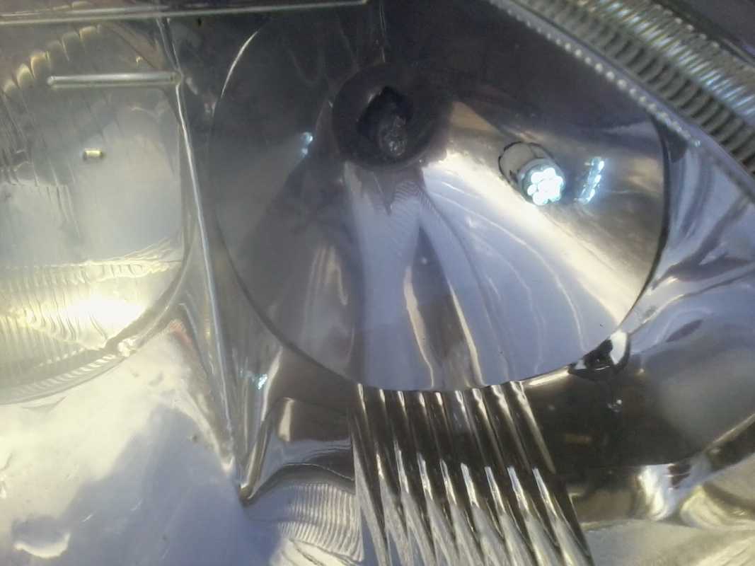

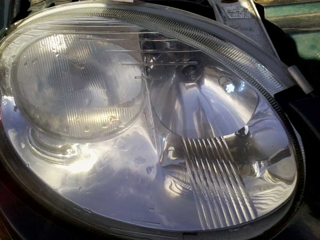

Step 7 - Fit the new bulb/LED (in my case LED) by just pushing it in.
Step 8 - Replace the side light housing by pushing it back into the hole it came from.
To be continued... can only add 8 pics at a time lol!

Part 2.
Step 9 - Replace the bulb cover by placing it back on and turning it to the right.
Step 10 - Switch the side lights on and check the bulb/LED works. Repeat on other headlight cluster. Done!
Enjoy your new side lights!
