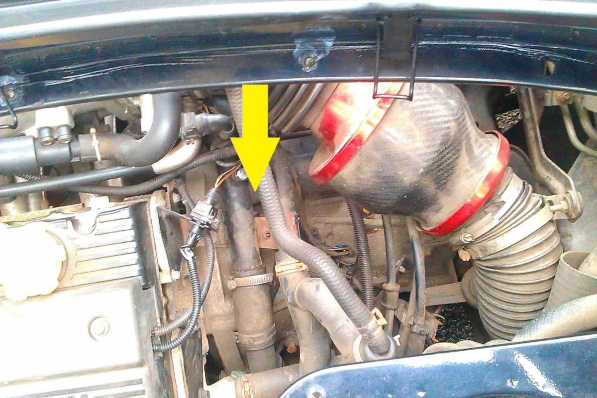

Access the engine by removing the access panel. The starter motor is down here.

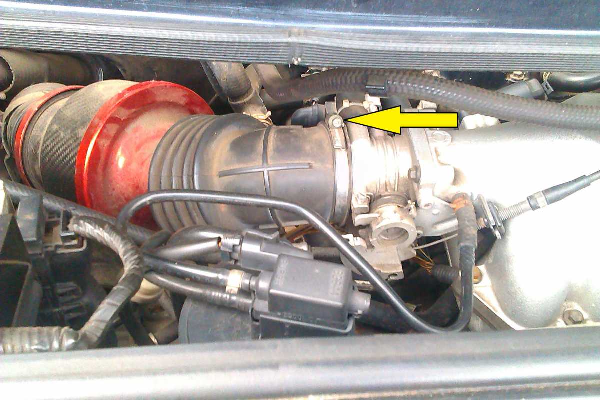

It was easy for me to remove the induction filter to get at the starter motor, by undoing this clip.

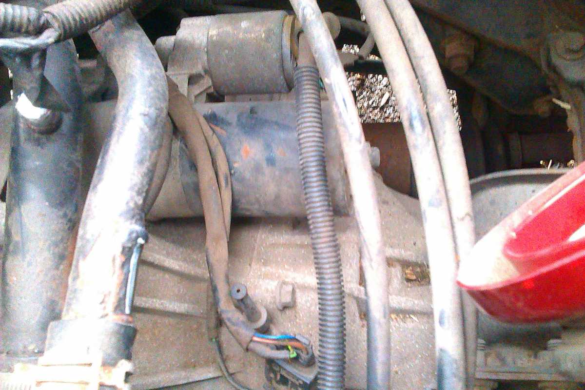

You can now see the starter motor.

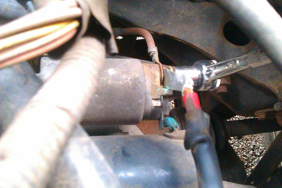

Pull back the rubber boot from the main ((red) cable. Undo the nut holding the red and brown cables.
Remove the connector from the spade terminal.

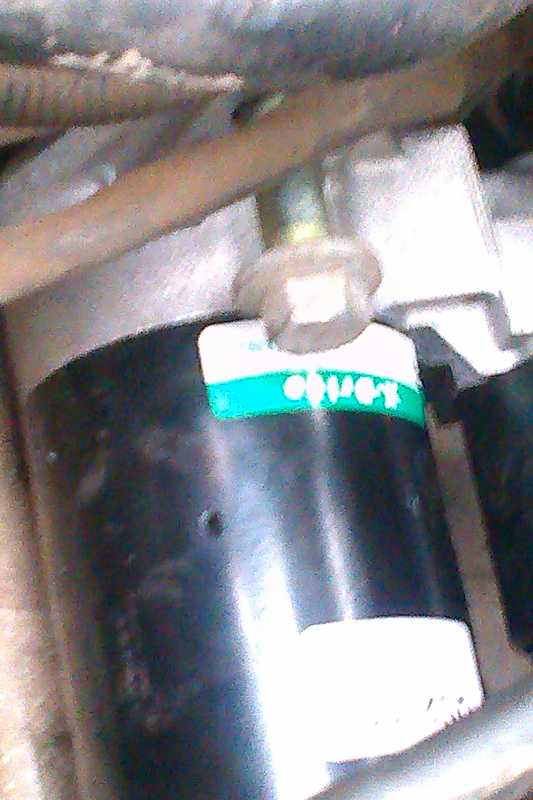

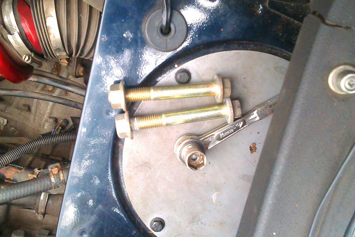

The starter is attached by two M10 17mm head bolts through the bell housing into two 19mm nuts(NOT captive).

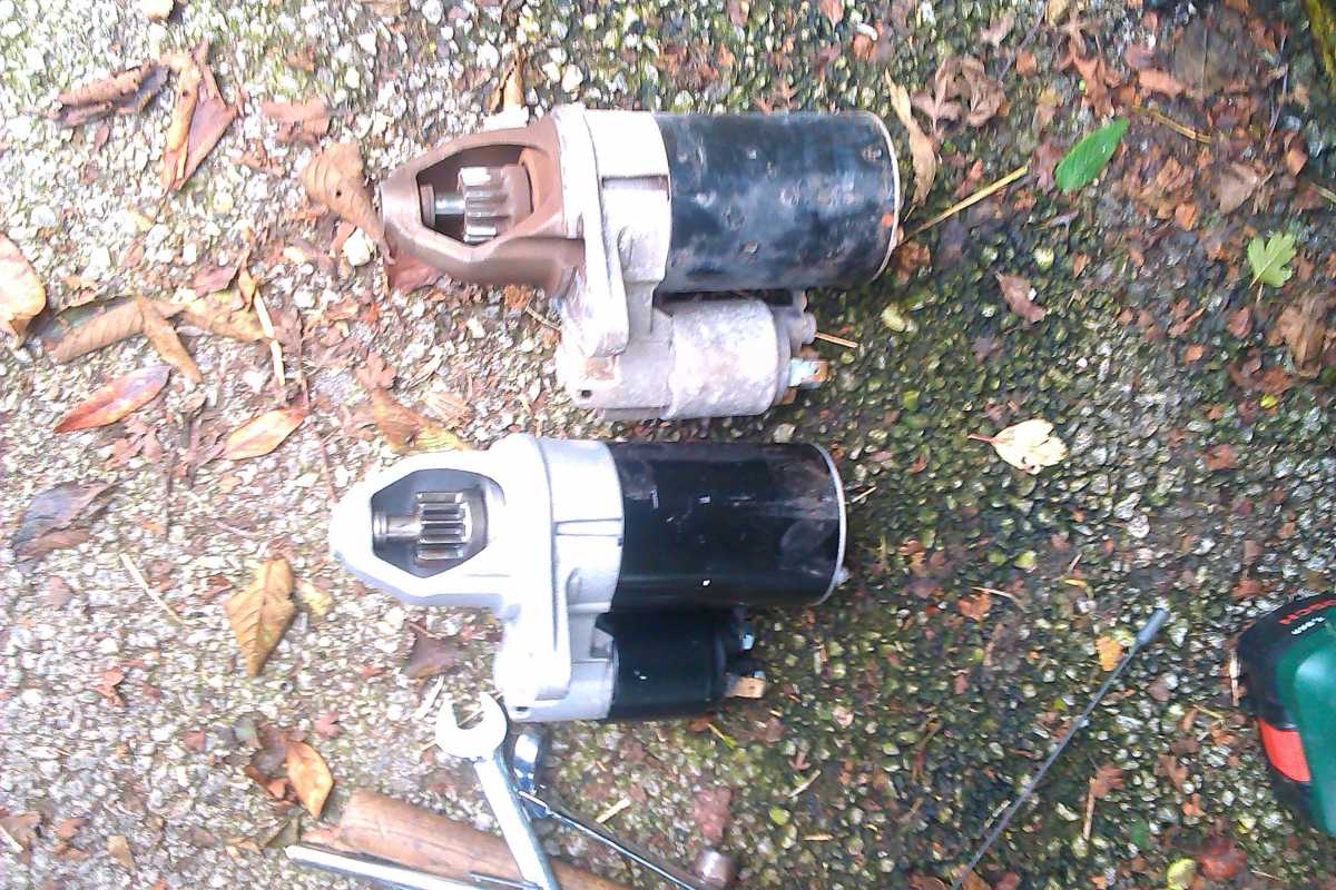

Pull out the starter. Here is the old and the new.

If you put the bolts through the new starter motor it makes it easier to fit it onto the bell housing.
Getting the nuts back onto the bolts is fun, and you need to get a spanner on to hold it while you tighten up and torque to 'kin tight.

David, Perhaps I am being a little pedantic but the starter motor holding bolts have a 17mm hex head and are not 17mm size bolts but are 10mm. Maybe the size you quote is for the dummies who can only size a nut or bolt by the size of the spanner used )) If you ordered a 17mm stud or bolt or nut from a supplier it would most certainly be 17mm diameter thread. Cheers, John
Replied by talkingcars on topic Starter Motor -How to remove/replace
Posted 7 years 11 months ago #187489
To be absolutely precise they are M10 bolts, i.e. the shaft diameter is "metric 10 mm".
A 17 mm bolt would be 17mm long, a 10mm bolt would be 10mm long.
Replied by David Aiketgate on topic Starter Motor -How to remove/replace
Posted 7 years 11 months ago #187495
yep. my bad. M10 bolts with 17mm hex head.
Replied by bryan young on topic Starter Motor -How to remove/replace
Posted 2 years 8 months ago #204535
I understood you, a 17mm socket for the head and a 19mm spanner for the nut, you didn't need to ay they were M10 bolts.
