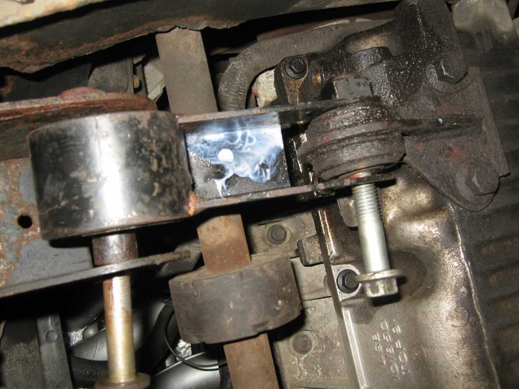

This torque tamer is there to limit the engine's rotation when power is applied. Most will have noticed that the 'k' series will rock forward and back as it revs. There is a beautiful poly bush solution that Clive has already fitted The polybushes are much stiffer than the original rubber. Clive mentioned a very slight increase in vibration at tickover.
This is an idea to replace the bush with a substance that is equally as durable as the poly bushes but not as stiff. It is probably allowing 50% less movement than the original. Plus hopefully not transfer any vibration from the engine to the body of the car.

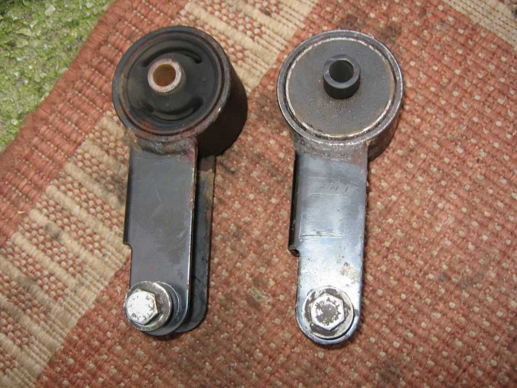

Darren supplied me with one of his torque tamer shackles. Basically Darren has replaced the standard rubber bush with a special poly mix as above. Darren can supply more technical details.
This is what you get.

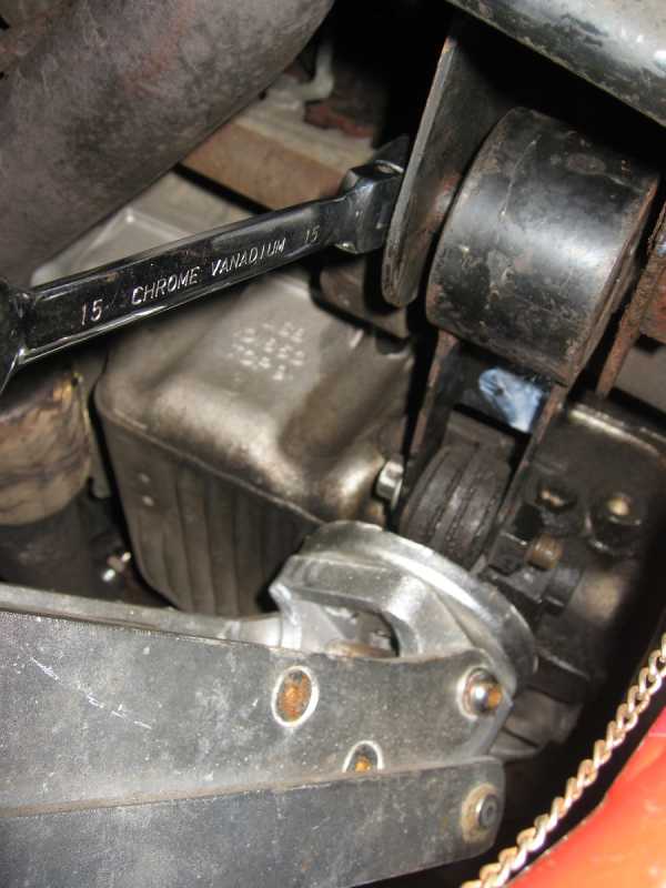

Here is the original in place attaching the engine sump to the subframe.

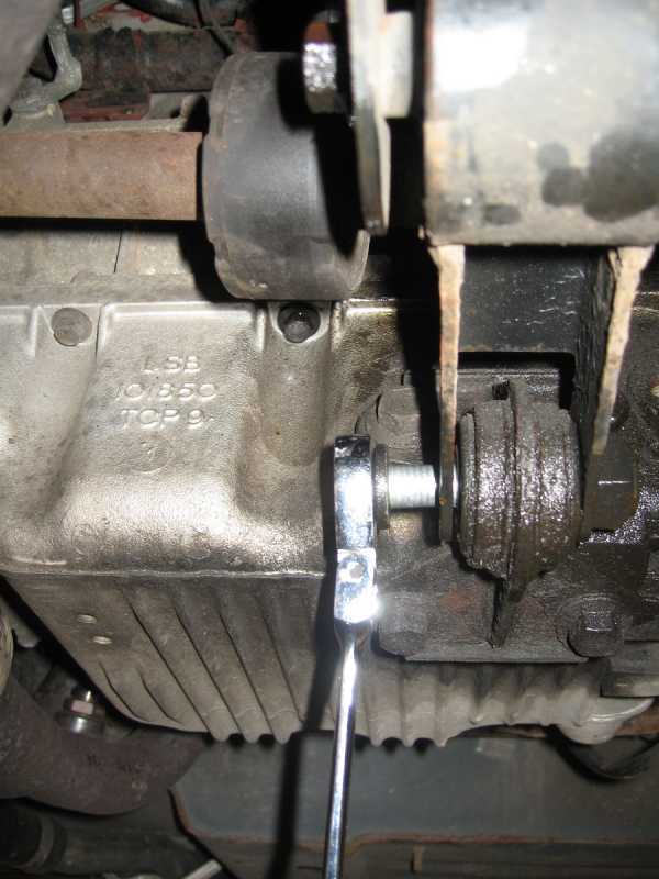

The two bolts are both 15mm hex head, the shorter one at the sump end is easier to take out.

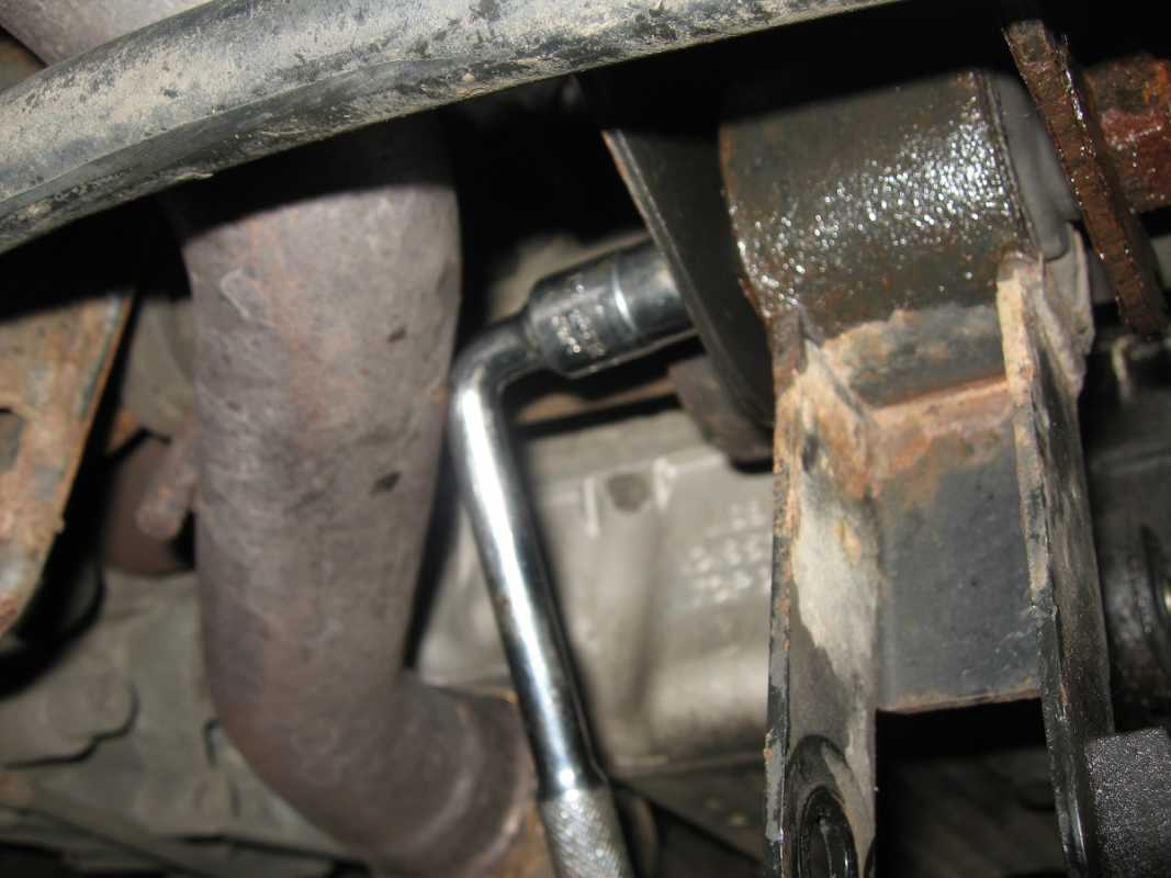

The larger bolt holding the subframe end is more problematic. Well it was for me. Lots of release fluid and a solid 'L' bar attachment on a good socket got it moving. The exhaust is a pain when you are trying to fully withdraw the bolt, but it can be manoeuvred out.

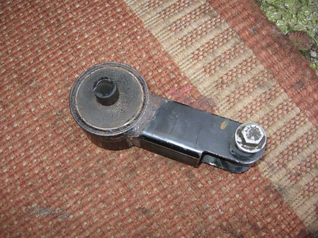

A comparison of old and new.
The original is very soft, and allows much more movement than Darren's.
In replacing you can feel the difference as it is difficult to line up the holes to insert the bolts.
I found that I had to lift the engine slightly on my jack to get both bolts in, and again the bigger bolt had to be 'encouraged' past the exhaust.

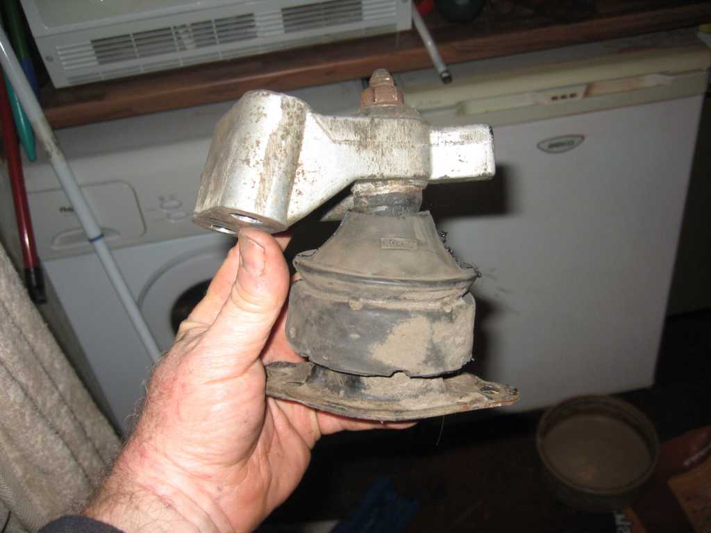

I wasn't getting any clonking from this area, but I have recently had to replace the middle pipe with flexi and the offside engine mount(which was the source of clonking.) The mount had pulled out of the top of the rubber cone.
By relacing this shackle, I'm working on the theory that prevention is better than the cure!
