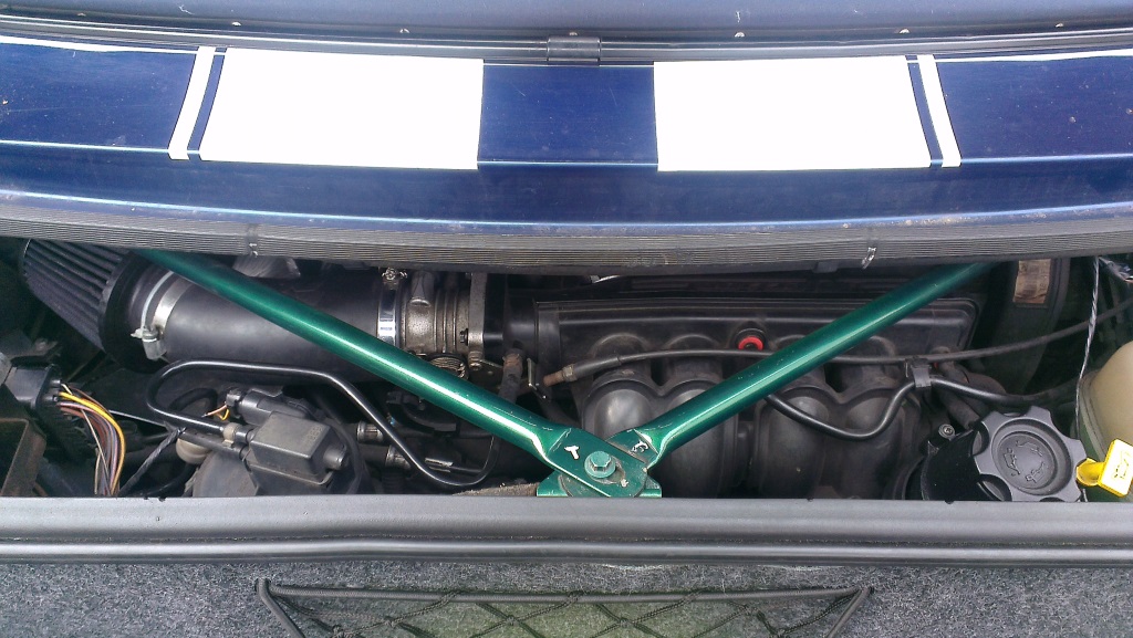

As you may have noticed I'm breaking a TF ( Click here to view ) and had wondered how much of an effect the two bracing bars in the engine compartment would have on an F.
So a couple of days ago I fitted them to the F and over the last couple of days did my regular 80 mile commute on roads I now know like the back of my hand.
On the first morning driving with the new modification I thought it felt a bit stiffer, but thought maybe it was just me wanting it to be an improvement. On the way home after a very long day I had completely forgotten about the modification and going into some fast corners realised just how much quicker the car settled into the corner. On another section, which has a series of quick left-right-left bends, the F just felt so much more controlled.
I would have described myself as a real doubting Thomas about these two metal bars but I have to admit, what a great improvement in handling! :woohoo:

What are the fixing points for the other ends Paul?
Replied by paulsmgf on topic I played with it, now its gone stiff
Posted 11 years 10 months ago #150132
they use 2 of the engine cover bolt holes but with larger bolts to secure into the bars
Replied by PQD44 on topic I played with it, now its gone stiff
Posted 11 years 10 months ago #150133
cairnsys wrote: What are the fixing points for the other ends Paul?
There are two additional holes and two additional bolts needed on the standard F engine cover. Mine is a Mk2 and already had the additional two holes in the body under the engine cover.
The boot bulkhead, unfortunately, did not have pre-drilled holes so I had to drill them out and fit a spacer to bridge the gap between the two skins and then used over-sized washers on the boot side of the bolts.

Interesting, are they flat at the other end as well? If so they should be easy to DIY.
Replied by PQD44 on topic I played with it, now it's gone stiff !
Posted 11 years 10 months ago #150139
The other end is flattened and has an extra metal piece which fits the groove on the underside of the engine bay opening (note in the photo the bar is upside down).
As mentioned Rimmers do the bars for just over £25 a pair but you will also need the bracket to fix to the boot bulkhead.
