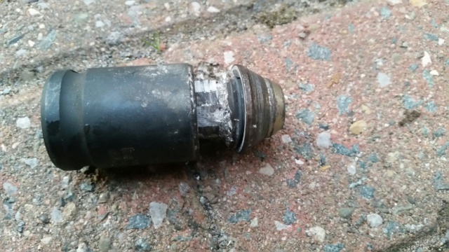

So I took a 19mm hardened steel impact socket and held it in some grips and heated it up until it was very hot. I then placed it over the nut with some pliers and then hit it on with a mallet. I then poured water on it to cool it down and grip the nut as it shrank. I was then able to use the torque wrench and undo the nut easily.

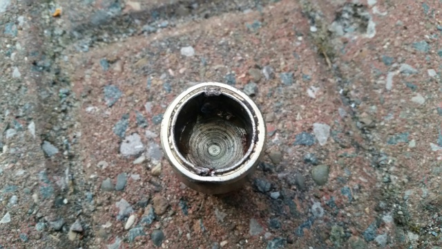

After hammering out the old nut, you can repeat for any other dodgy nuts. It was actually surprisingly easy and as you can see from the picture the metal of the nut is soft enough to allow a heated socket to be hit over it.
The hardest part was hammering out the nut to repeat the procedure on the other wheel!
