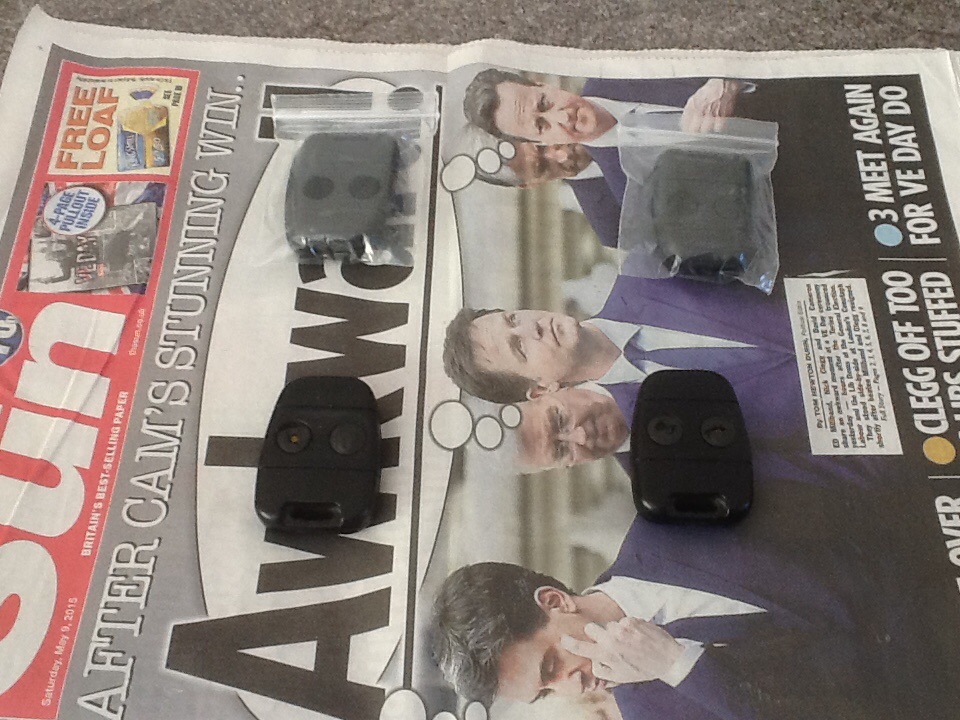

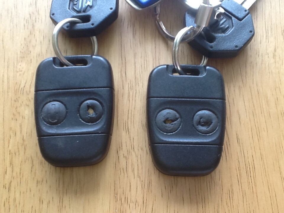

Does your fob look like these??
A full, in depth replacement guide is here!!

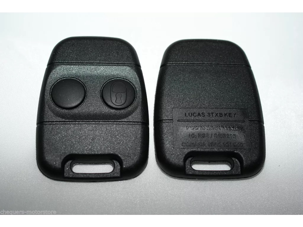

Firstly, log on to eBay and search for mg rover fob.
I found these at a very reasonable £3.55 each inc free delivery.
Now, choose your workspace, I chose the breakfast bar in the kitchen but any flat surface will do.

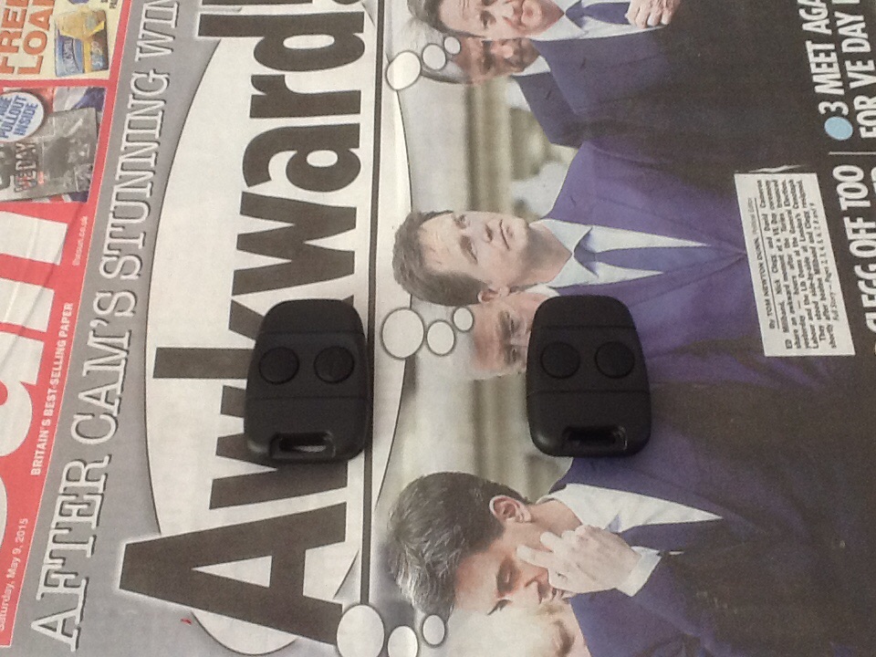

Lay out your fobs and replacement fobs.

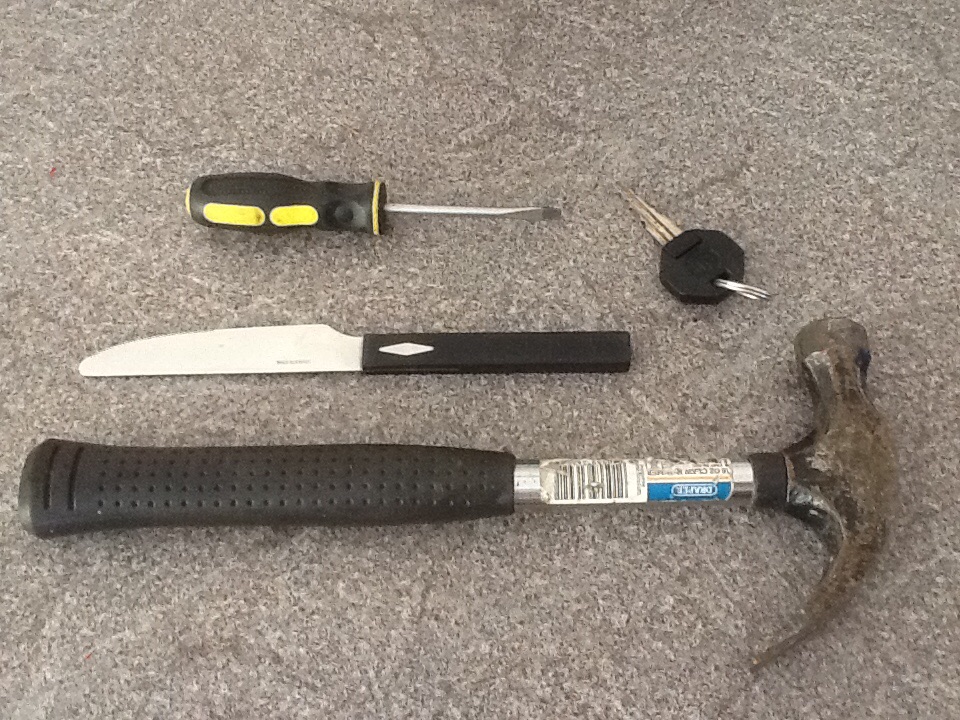

And some that will.
Although you may need to be a bit careful with the hammer :whistle:

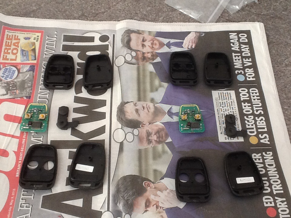

Once you've got them open, carefully lift out the circuit board like so...

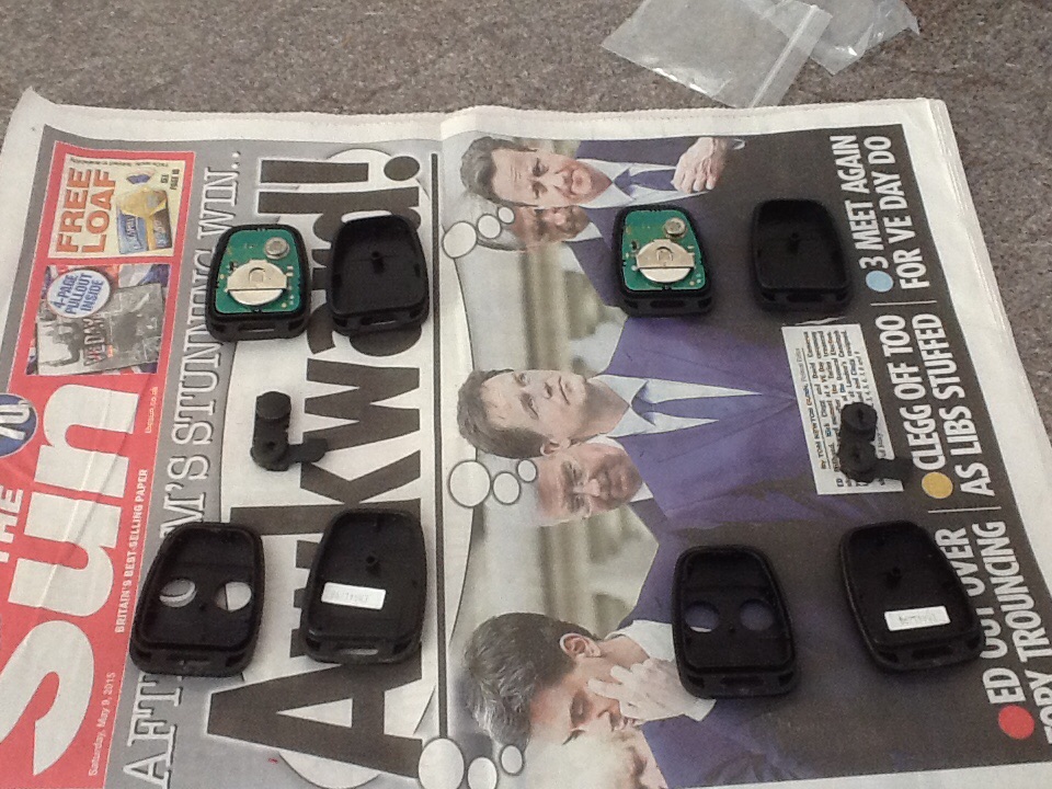

Now, place the board into the button side of the new fob.
You may need/want to change the battery for a new cr2025.
Don't buy pound shop ones as they're rubbish, buy cheap, buy twice!!
Now, place the back of the new fob on the front part and squeeze until you hear a snap as it clicks into place.

Sorry, but you have made one potentially catastrophic mistake! :spank:
Only do one at a time. Make sure the first one is working before starting the second.
That way, even if you mess up, you will still have one working fob.
