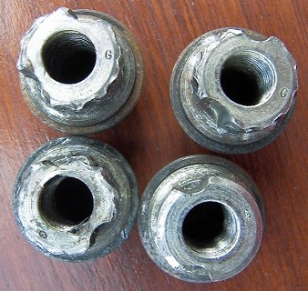

but... now another problem... opposite wheel i have a wheel nut that seems to be rounded and the wheel wrench just twists off
my thoughts here are..
cut a slot in the top and somehow try using some kind of screwdriver... prolly result in destruction of the top of the nut and still not work...
or... use an undersized socket .. big hammer it on and remove that way... potentially damage nut even further and still not work
any other ideas ???

A slightly smaller bi-hex socket hammered on after a good soak in plus-gas should work.

Time to buy some new wheel nuts methinks.
Had this problem with the project MGF. Despite it saying not to use powert ools on the nuts most places know better and do so and of course wreck the nuts.
I bought a new set off the dreaded bay of E for £20.

Is it the 'soft as butter' chrome nut cover that is spinning round? If so can you get it off the nut? A screwdriver bashed in to it sometimes allows you to pull it off by splitting it off the nut. If you can, then an 18mm socket fits the nut perfectly - I know as one of Meg's has been 'chrome capless' for years!

Thanks for all the replies... those irwin tools look cool but .. dont wanna splash out on a tool Ill use only once (hang on .. scratches head and counts back all the rounded b'stard nuts ive had to grind, drill, cut and curse at in the past 50 yrs)... hmm could be worth 20 notes :)
