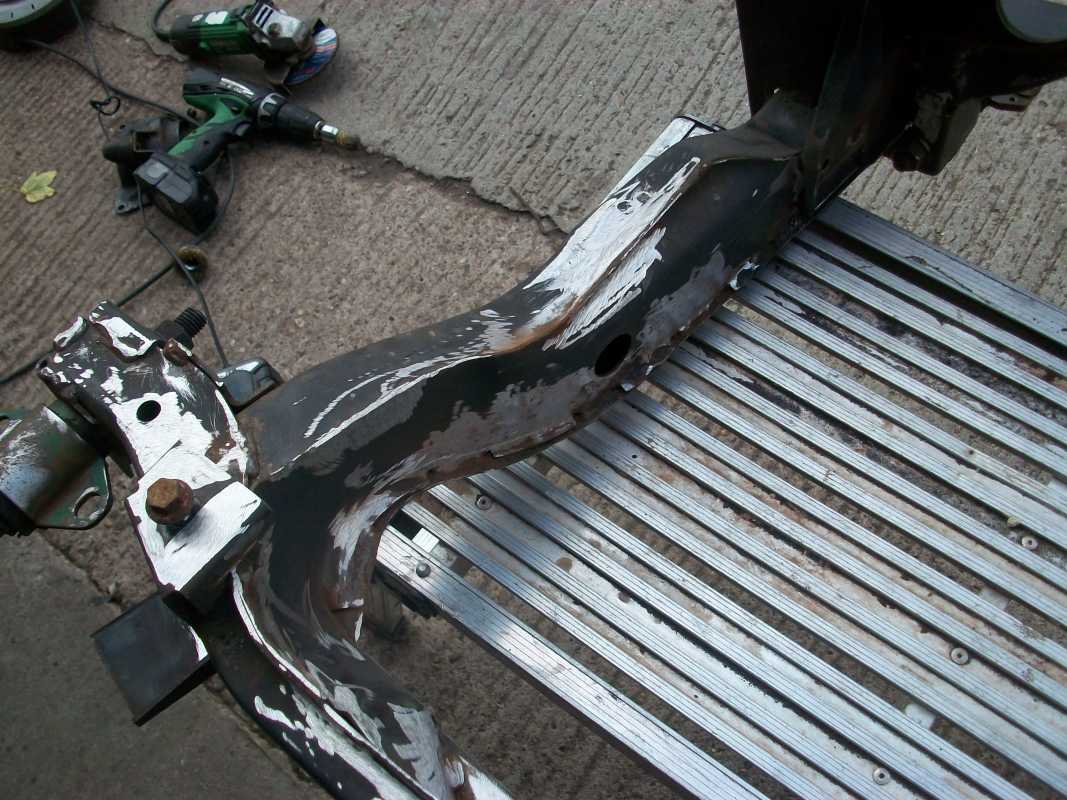

A worthwhile job the subframe prepping i found was quite time consuming.No great costs involved,stripped front end off and waxoyled underneath and underneath of tub.Only thing make sure you have a suspension pump for when subframe refitted.
The subframe rust grinded off zinc primered and repainted.
Ideally better on a ramp but as i done this over a period i couldnt commit to leaving it on our ramp as we need it for customers cars.

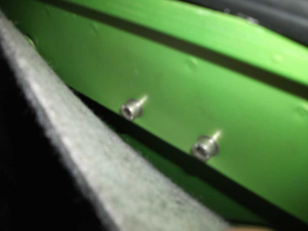

Yes i have fitted tf front subframe braces and the the rear one in pictures.The centre brace behind heater control i have in pictures i have plans to take the interior out and sound proof the cockpit in autumn and fit some spanking tf carpets they are all in one & foamed backed much better,i will fit the centre dash brace,once eveything removed
Both subframes are coming back down christmas holidays ,so while its on ramp after delibarating for a while i have decided to have the inside front end painted the same colour i kept it racing green on original paintjob as i left the option of putting it back original colour one day but made me mind up when me new helmet matched the colour (just jesting).I have attached pictures of my mgf before and after i had it painted.I recently also resprayed inside boot. just bought a 51 reg original racing hff at bottom of post,its not mint but not that bad,keeping it original so going for it on the bogey green on my other one.
