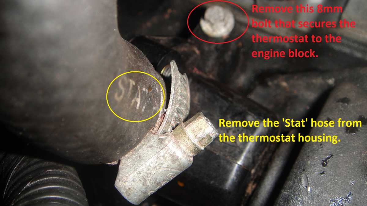

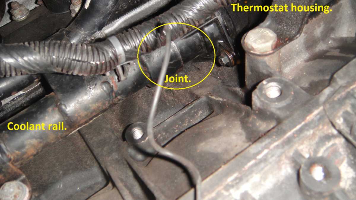

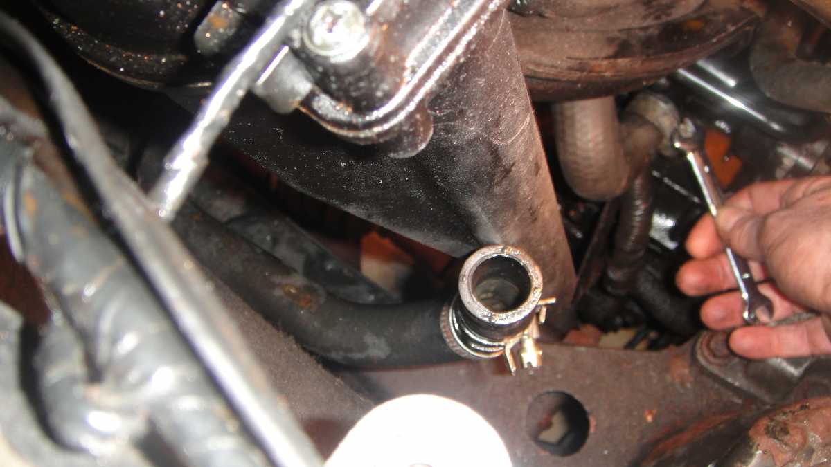

I backed the car up onto some wheel ramps intending to try and do the job from underneath. In the end, I removed the expansion tank and did the job mainly from there. Other than a TF160, when you're replacing the whole thermostat unit there's only two bolts you need to remove. The 160 has an oil cooler bolted on top of the coolant rail which makes things tougher to get at.
Be prepared to lose 3 or 4 litres of coolant doing this job.

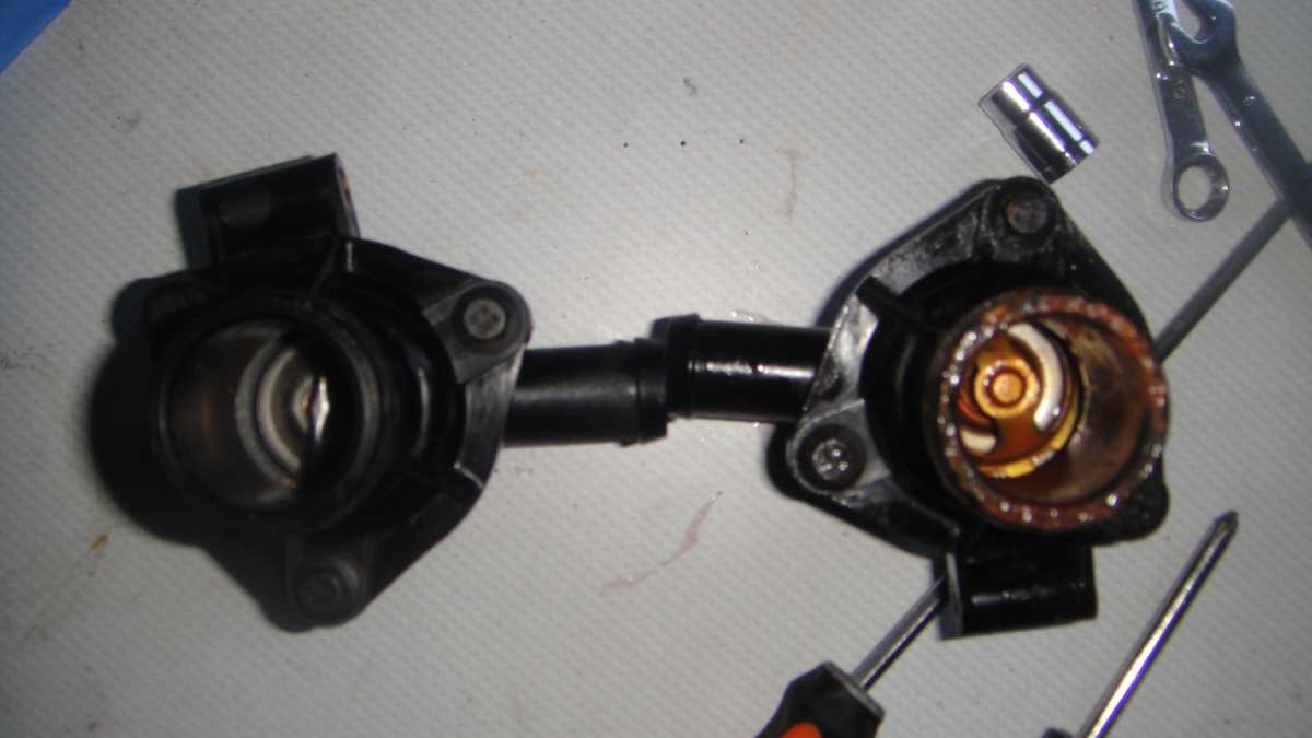

You can now lift the old stat out and compare it with the new one that you're going to fit.

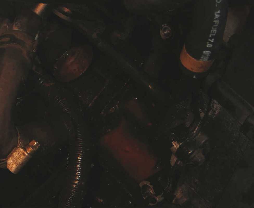

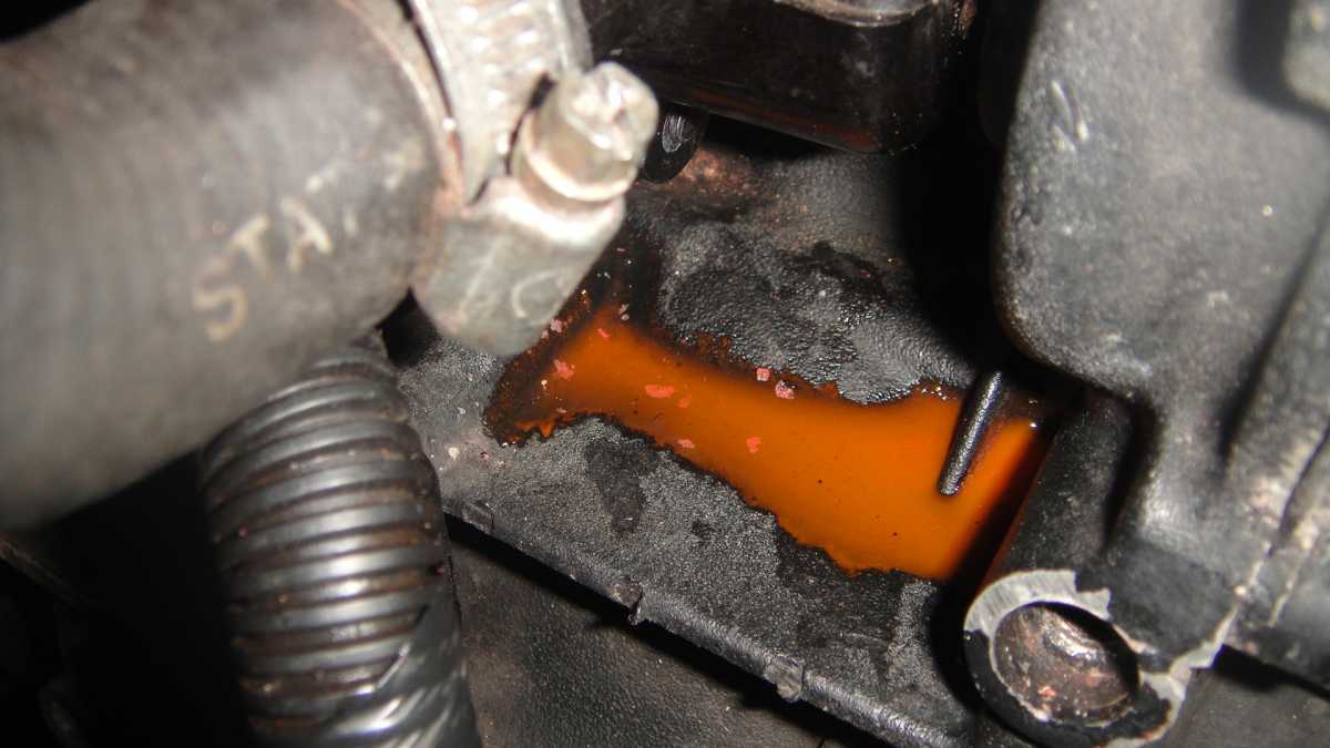

The space where the old stat was.

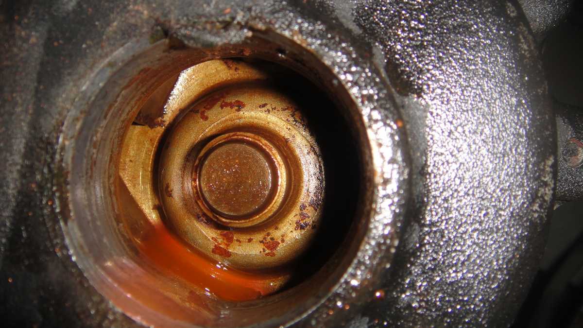

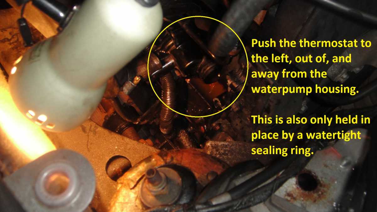

Clean out the pipes on the coolant rail and the waterpump before inserting the new stat. The left side pushes into the coolant rail below.
The right side pushes into the waterpump below.

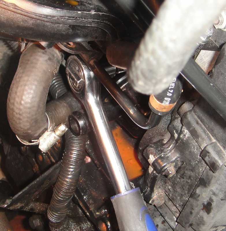

Bolt the stat onto the engine block like so.
Resecure the hose to the thermostat.

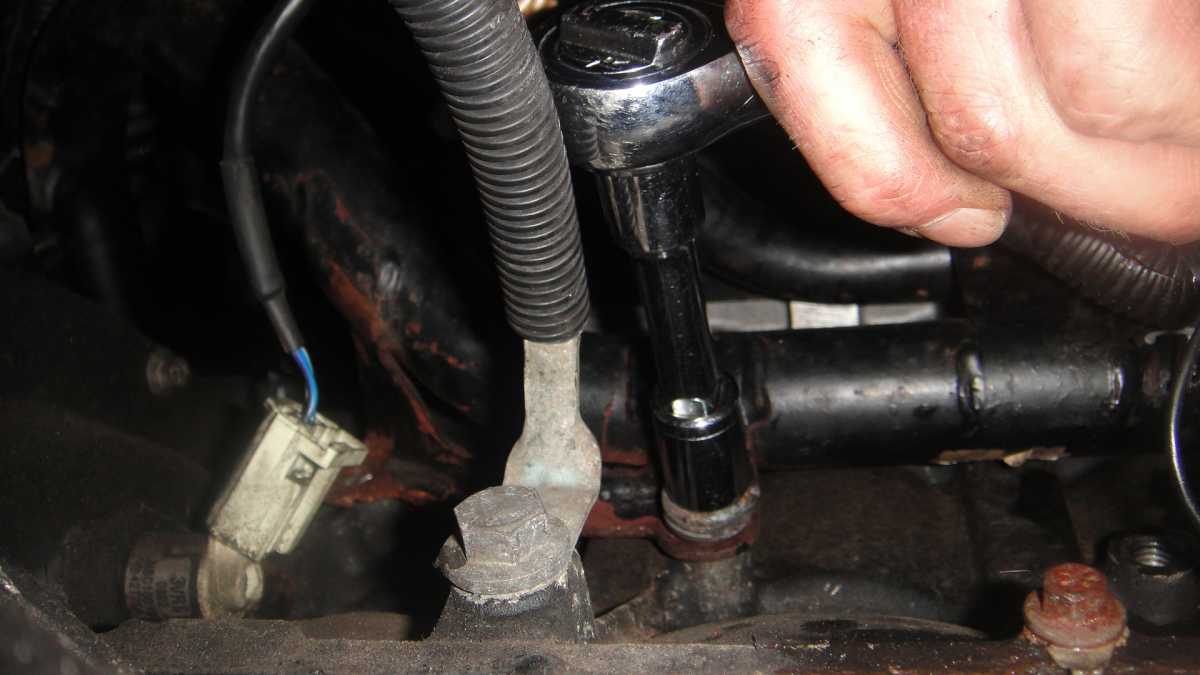

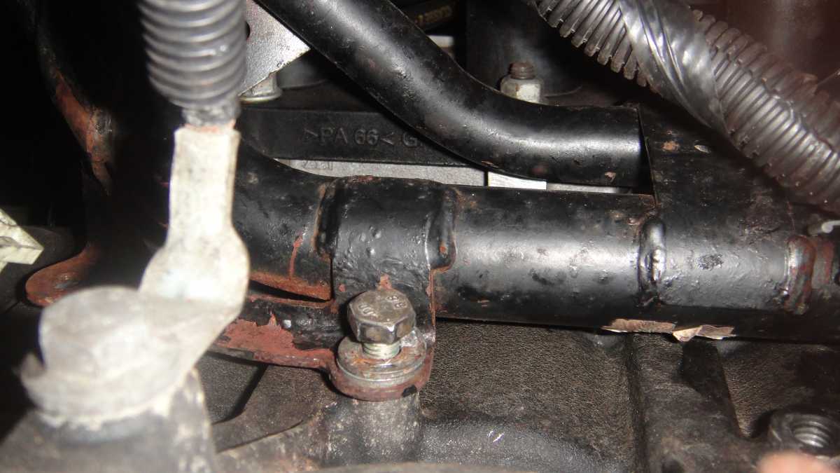

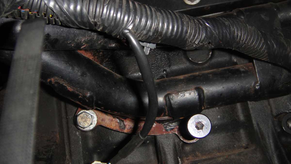

Resecure the 13mm coolant rail bolt.
As you can see in the pic above I only had one bolt. But there's room for two. So I improvised and added another. This held the coolant rail securely.

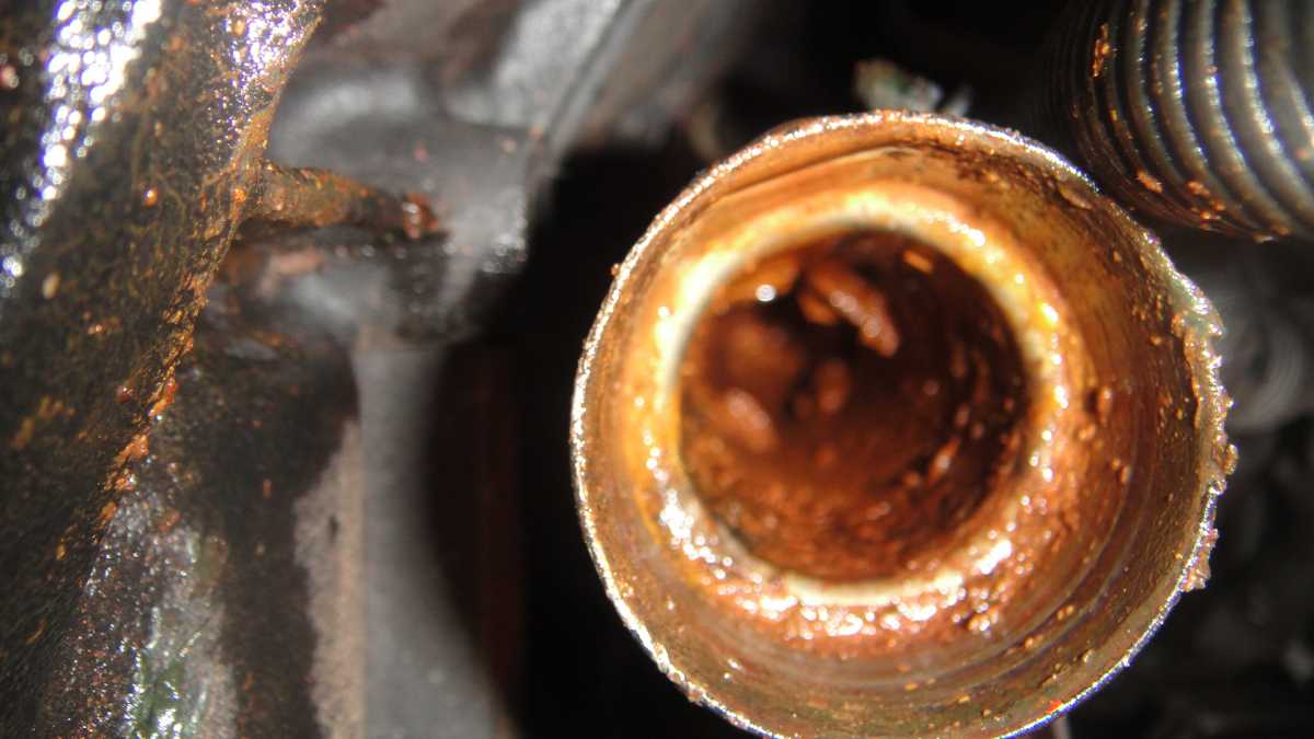

In the pic above you can see the crud I dragged from the coolant rail. I can only describe it as little lumps of 'red clay'. Anybody seen that before?
Pre 2002 MG Thermostat replacement. 11 years 4 months ago #91632
I've seen that in many engines, although generally you find more in cast iron engines. It is a mix of rust from ferrous components, deteriorated anti-freeze, and silt and crud from water. It could also be the remains of K-Seal or a similar product used by a previous owner or mechanic. With the amount visible in your engine I wouldn't be surprised if that is what it is.
