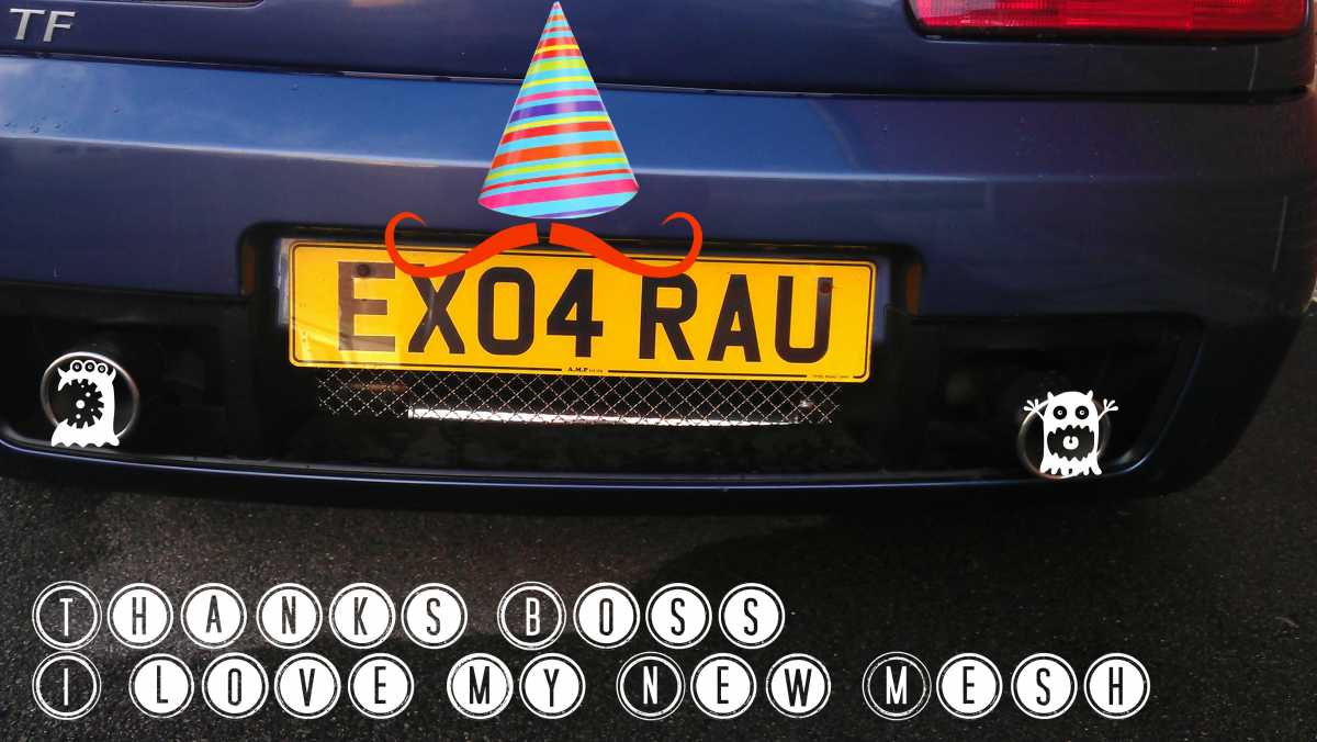

So I got some nice mesh and then some more from lovely PQD44. And here's my attempt.
I did this without taking the rear bumper off as I could do everything I needed while the car exhaust was off.
When the side grills, boot and front are done I'll add some more

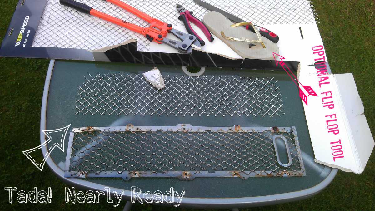

Tools Required:
  • Bolt Cropper / heavy duty snips
  • Sealant
  • Tie Wraps
  • Tape Measure
  • Flip Flop

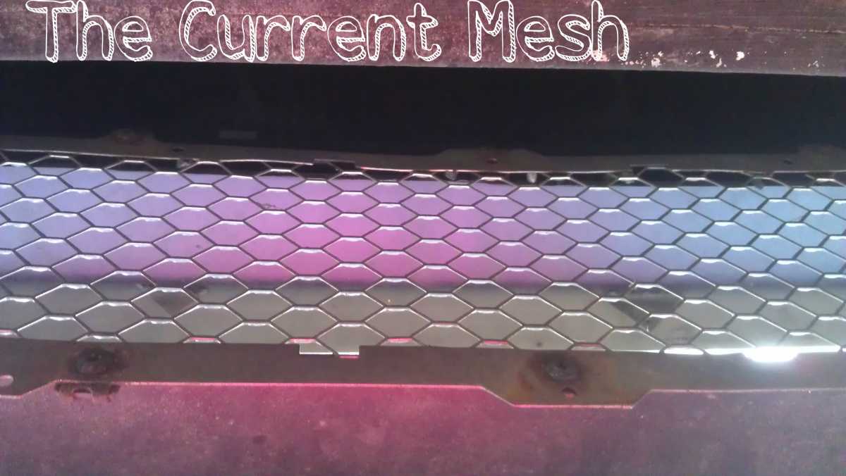

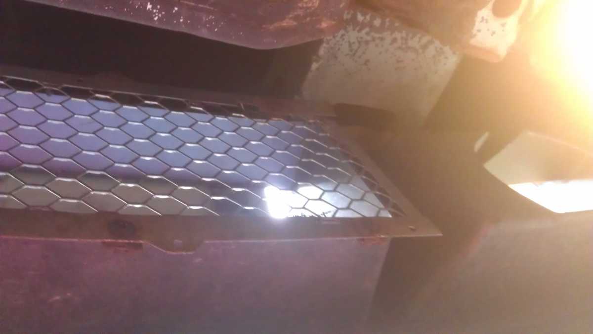

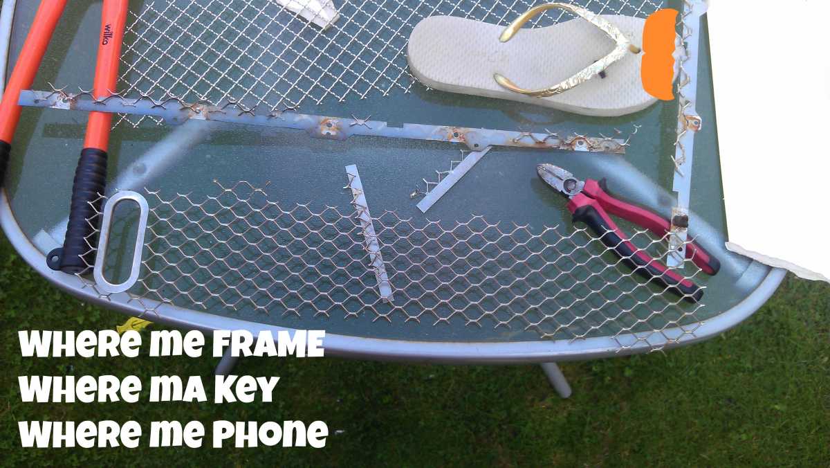

So step one is to see what the mesh looks like.

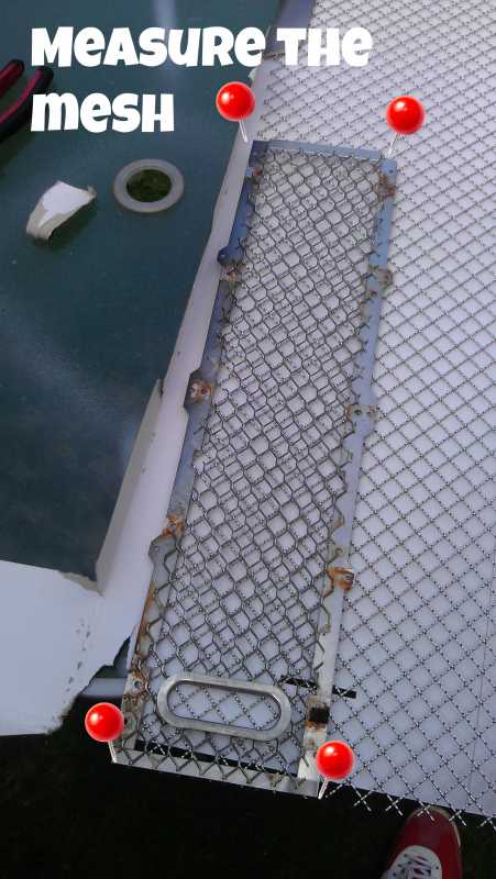

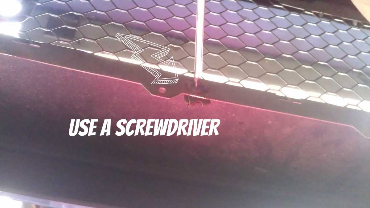

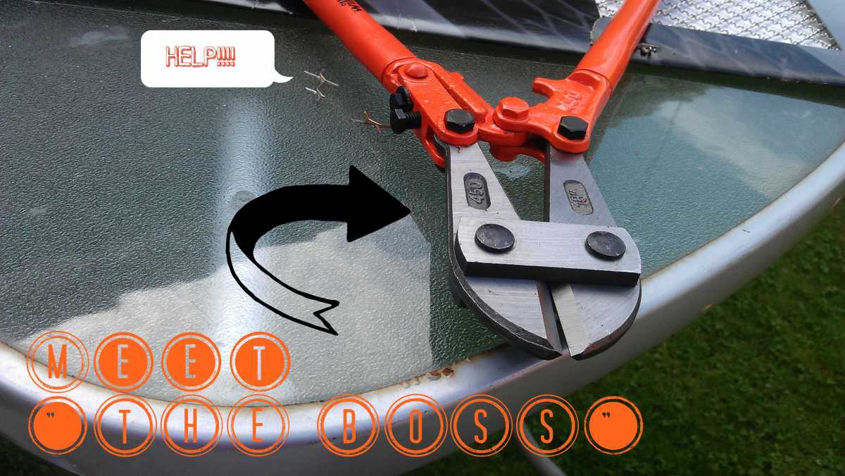

There are many bolts that will be corroded. You can take some of em out with the screw driver but I had to use the good old dremel to grind the heads off.
Then when its off measure the dimensions and make a note of it or you might regret later :oops: (Like someone I know did :sick: ) :dry:

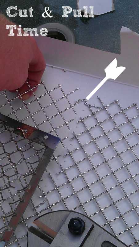

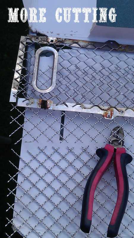

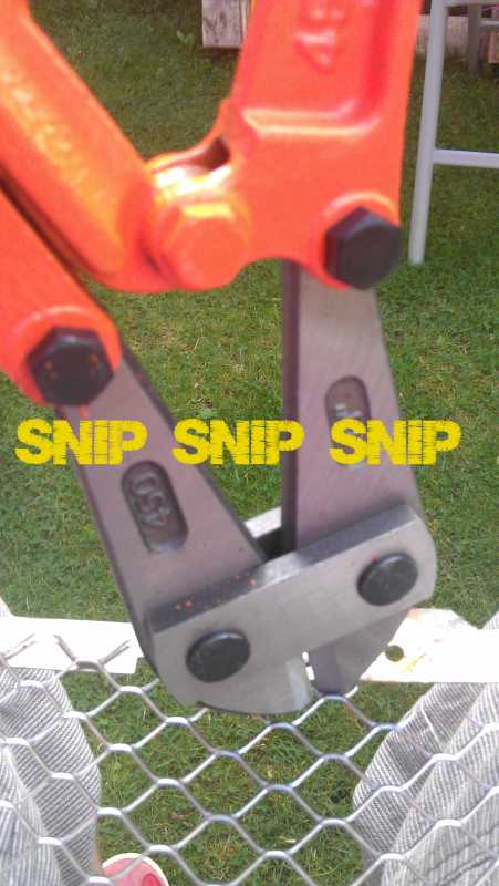

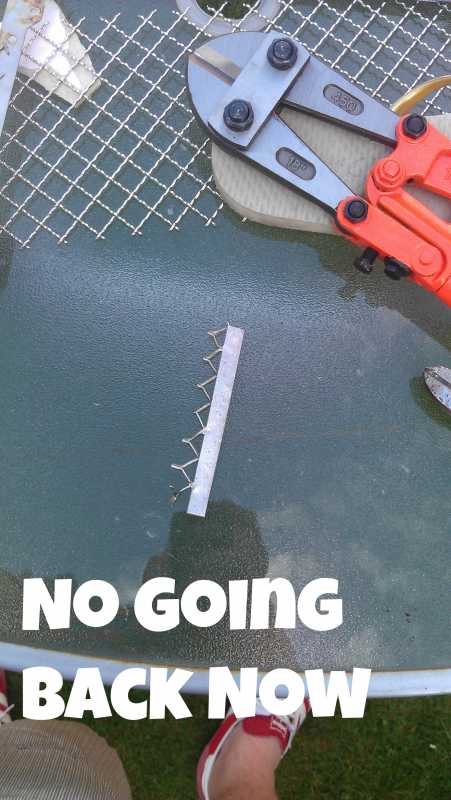

Then get cutting a bit
As its the stainless steel superior trim to the feable toaster trim as standard on the TF it takes some doing. Measure once and cut one.

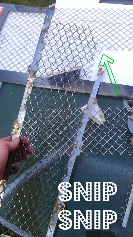

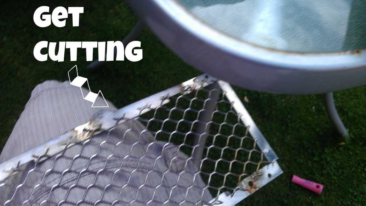

So the new mesh is ready... What about the old one then? You can either be a hero (or stupid... :slapme: ) and go for it like I did or buy a replacement frame, or make your own.
Then cut the current mesh out of its frame.
The flipflop is a very useful anti stab implementing tool saves you getting stabbed by the mesh as your getting friendly with it.
Now... The bit I'm missing... Sorry :spank:
I put sealant on the frame pushed the mesh into the frame then tiewrapped the frame in untill it went off.
Then put sealant around the frame, in future i'll be using sticks like sh*t :broon:
Then put tie wraps into the holes where the previous screws were let it go off and then all is well.....
:woohoo:

bit of overkill with the bolt croppers maybe? :whistle:
Standard side-cutters (wire snips to some) work just fine. So long as they don't come from Bongo's drill bit and tool supplier!! :yesnod:
