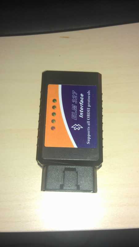

What you get:
1 * Bluetooth Adapter
1 * CD Rom
How does it work then?

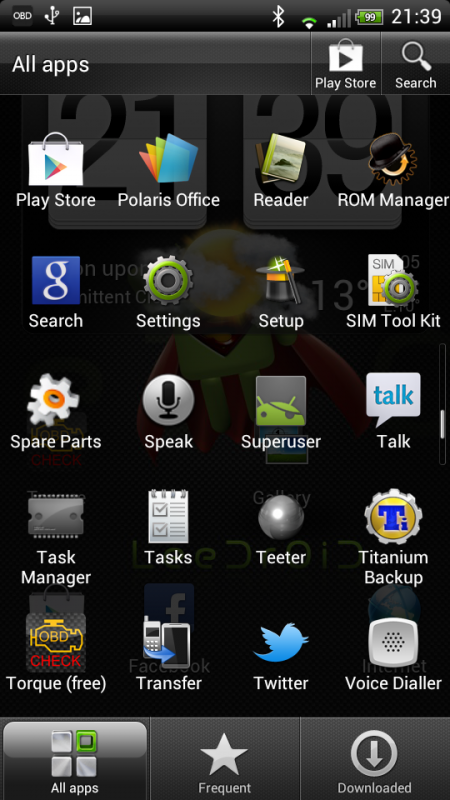

Install and load an app called "Torque"

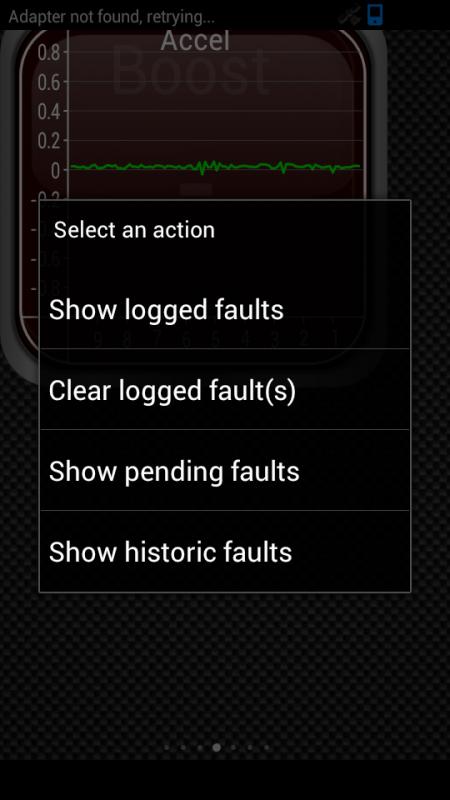

Then click the menu button on your phone and show faults.
This will show you whats up, just have a look at all the faults while your there and you should spot on.
Mine was a magical "P0313 - Low Fuel Misfire" eh?
So I cleared it and I'll wait and see if it comes back and investigate further.

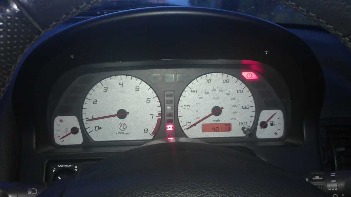

Engine management light is now off :)

Invalid or non-existent item ID.This is what I bought, was delivered in 2 days:
