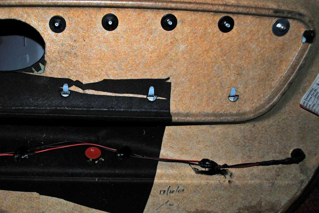

Two separate lights
A red led with reflector. A powerful white downlight in the arm rest.
Simply fitted by drilling two 20mm holes in the door card and fitting the lights. The red light is a simple push fit. The White light has a removable bezel, so that the light is pushed through from behind, and the bezel screwed on to secure. The wiring, I secured with a couple of blobs of silicone sealant.

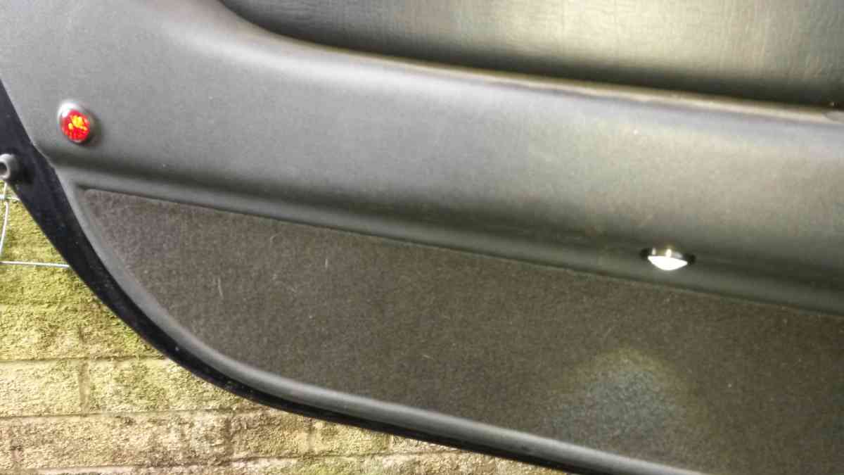

Does a good job I think. No 'how to' then?
I used these lights for the downlighters.
They are very bright, and I also used them as DRLs as well.
These red ones
Red LED Round Warning Indicator Car dash light 24v
Completed
