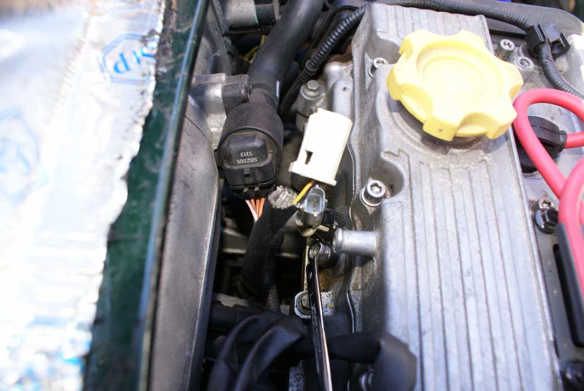

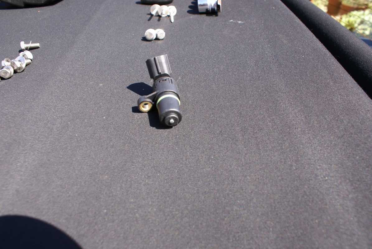

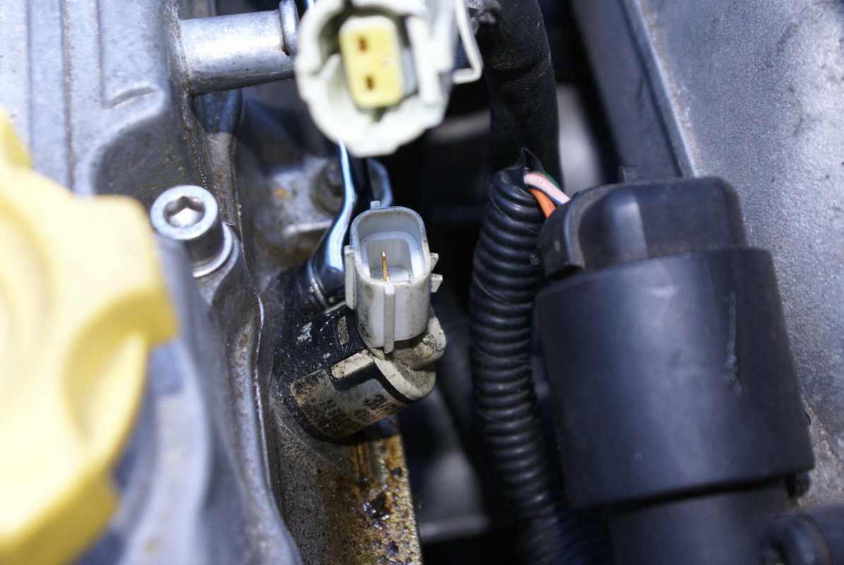

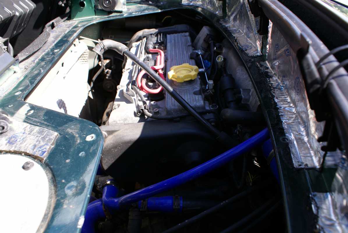

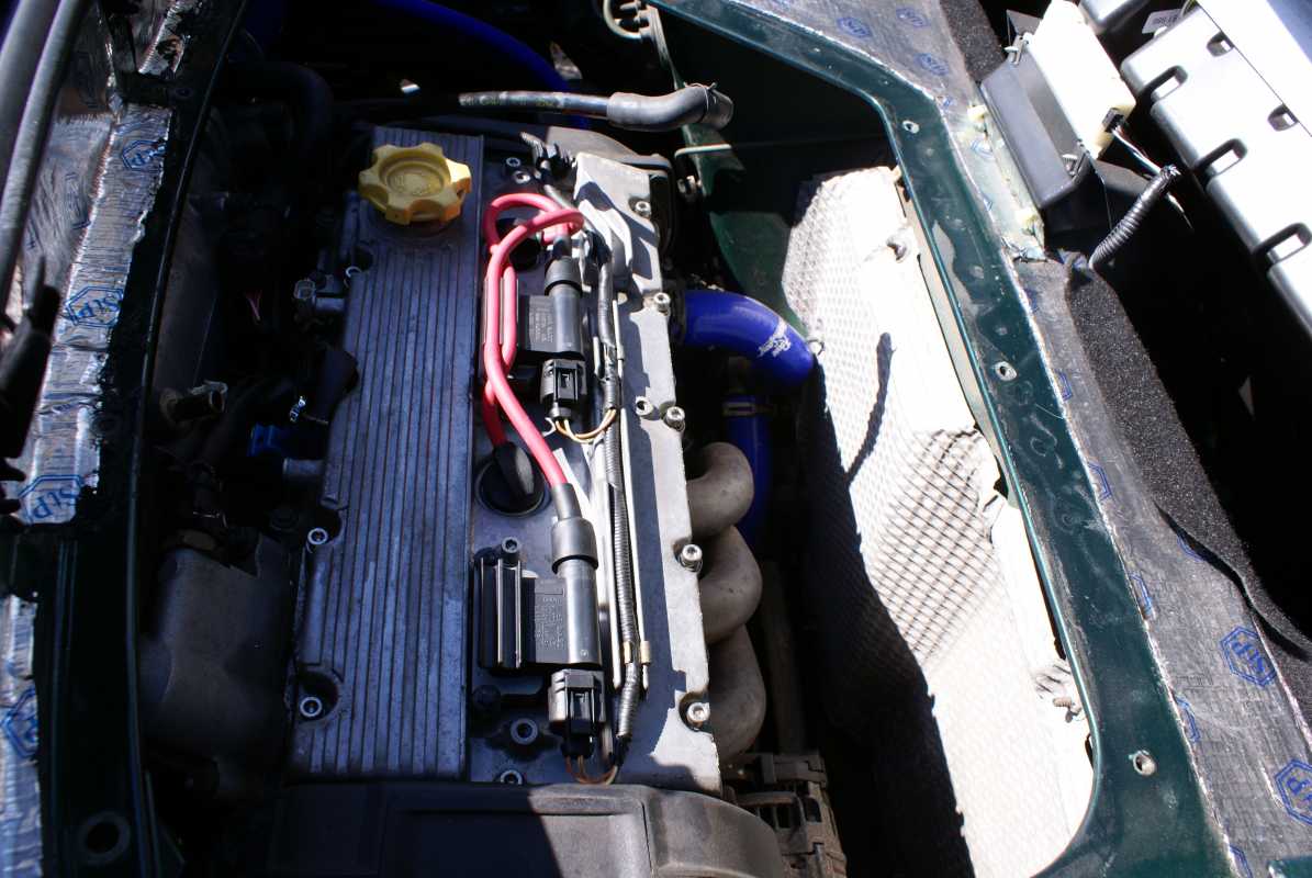

For some time now I have had a misfire problem making my VVC engined car a bit jerky while running. I would have to press the gas peddle to stop it jerking. Well after a couple of posts on here and the F Reg I was told by someone else that they had a problem very much the same as I had and it was cured with a new cam sensor. So I set about changing my cam sensor To unplug the sensor you push the top of it in.As you look at it there is a bit proud . Here are some pics of the procedure.
You will also need a small 7mm spanner, an 8 mm spanner and a 10 mm spanner. The sensor is on the opposite side of the engine to the 18i model but the procedure is the same.

Hi Red rooster if you read the post it says the cam sensor is not under the plug cover if you look at your engine from the drivers side the sensor is on the left and in the middle of the engine as the picture show, you will need a 7mm spanner to get the single bolt off the cam sensor is £49 and the crank is about the same so I would just get the cam first and see how it goes
