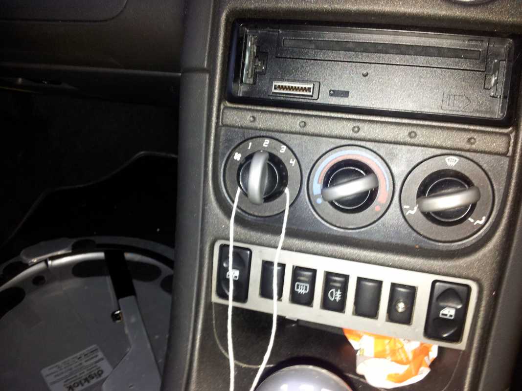

What you need...

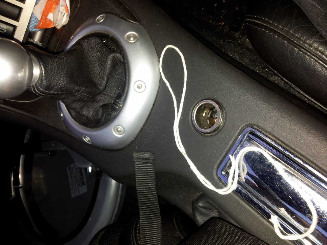

A length of string and your new knobs.

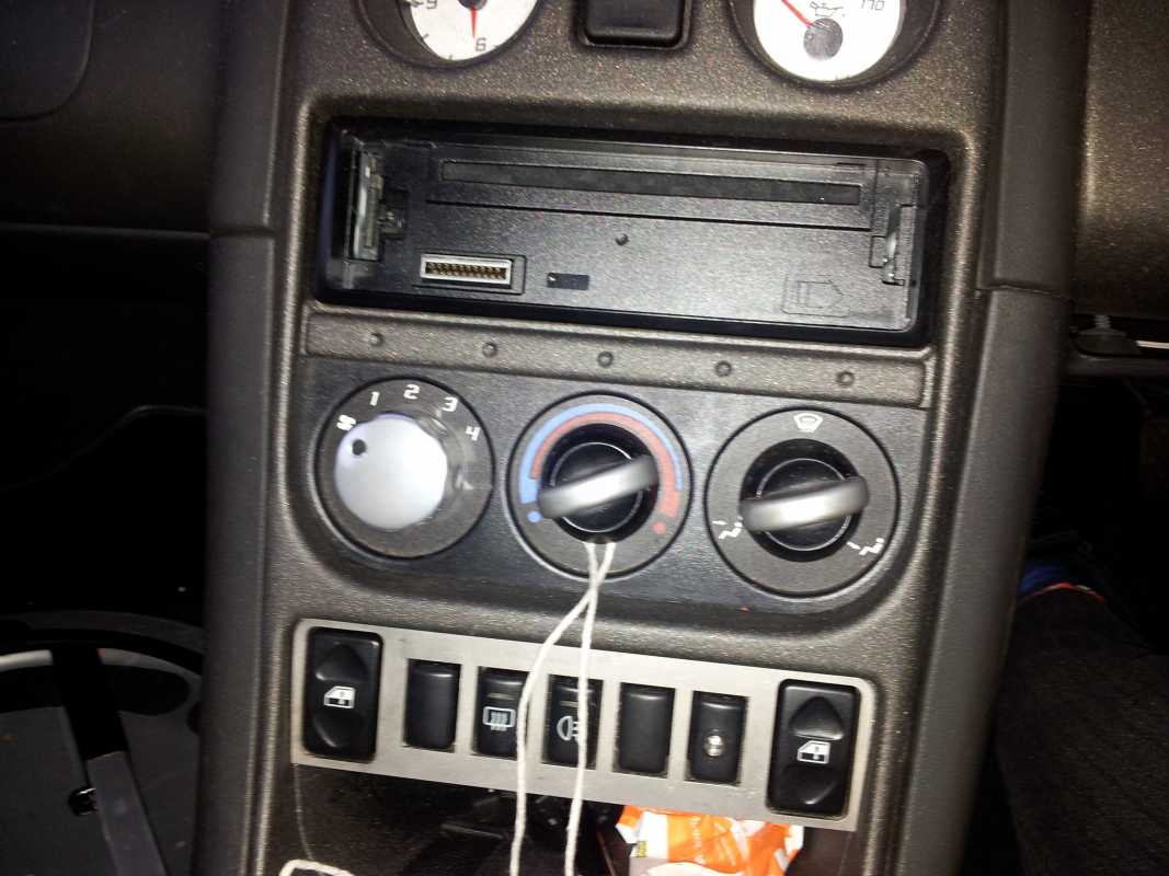

Wrap the string around your old knob, loop a bit at the bottom and PULL. It should pop off easy enough.

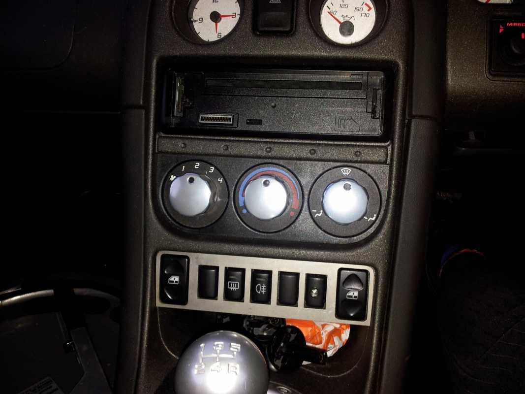

Then get out your new shiny superior knob ( :oops: :woowoo: ) then push it on on by lining up a lug on the inside of the knob with the metal thing inside the heater controls. It feels a bit stiff when you push it on, this is usual knob behaviour :whistle: :bat:
Ooooh Look look one done 2 to go...
Continue in this fashion until all 3 are done.
Then admire your handy work and gloat / convert the people who have plastic knobs to give in to temptation and join us...
Takes around 3 mins to do this mod and the controls feel a bit stronger .
