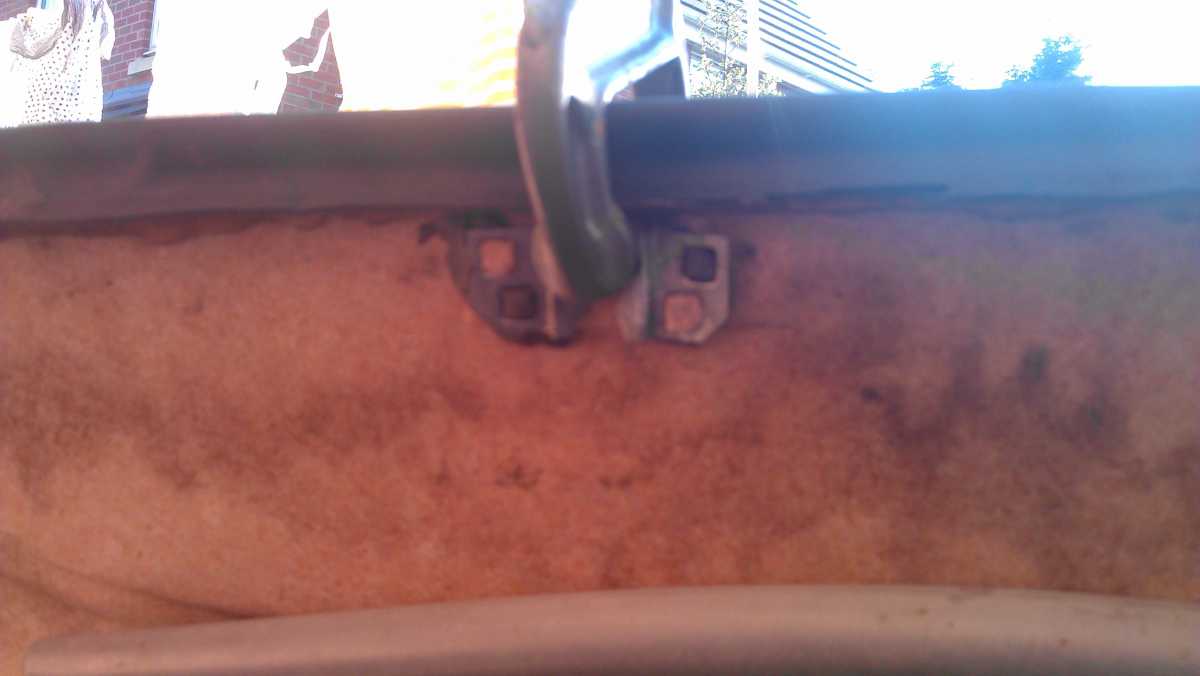

One of the broken clips:

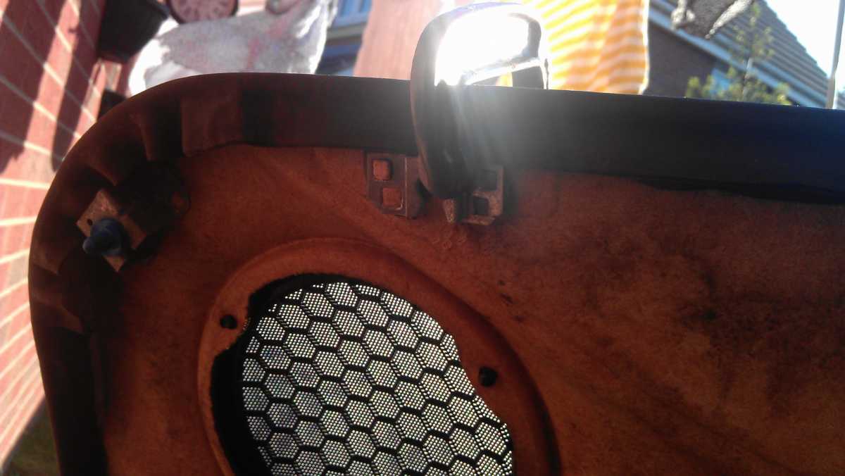

Another:

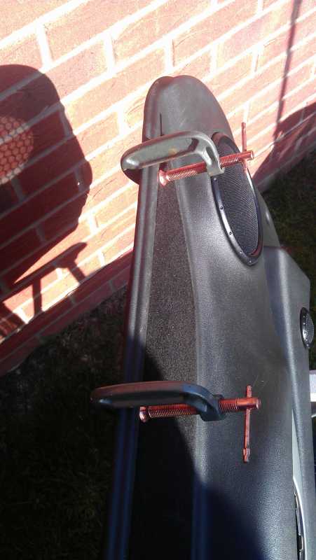

Both clips setting with the araldite. Just left em 30mins just be sure.
It sets like screws but it didn't damage anything.
