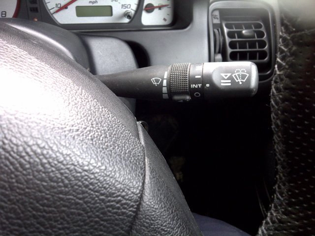

Not a problem but a 10 minute aesthetic upgrade. The Rover 800 / Freelander stalks feel so much better and look OEM compared to the thin shiny black stalks fitted as standard, which look slightly out of place. The stalks are a direct replacement and use the same connectors as the F/TF.

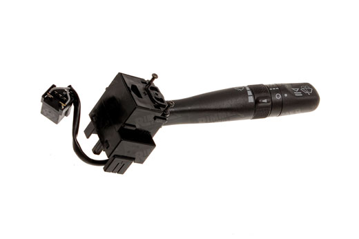

I went on ebay and for the princely sum of £1.99 won a set of Rover 800 stalks. My postman was slightly intrigued by what I was up to now when handing over the parcel

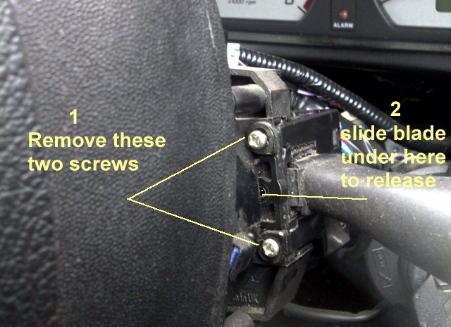

Remove the two stalks by removing the two retaining screws on each side and then use a blade to release them from the main housing.

The loose connector on the wire does not connect to anything on the F/TF, this is for the variable time intermittent wipe on the 800.

1) Remove the screws holding the steering column trim and remove trim
2) From the straight ahead position rotate the steering wheel 90o clockwise to expose the retaining screws on the wiper stalk.
Remove the two screws and connector then replace the wiper stalk then refit the two screws.

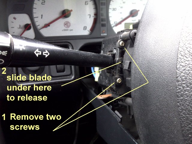

3) Rotate the steering wheel to expose the retaining screws on the lights stalk.
Remove the two screws and connector then replace the light stalk then refit the two screws.

The new wiper stalk does have a variable speed intermittent slider setting which is not compatible with the F / TF. I know a lot of people have had a look into this but I’m not sure if an easy usable solution has been found. Personally I don’t use the variable timer wipe on the other cars I have anyway. If you know of an easy fix for the variable time wipe then feel free to add it below.
