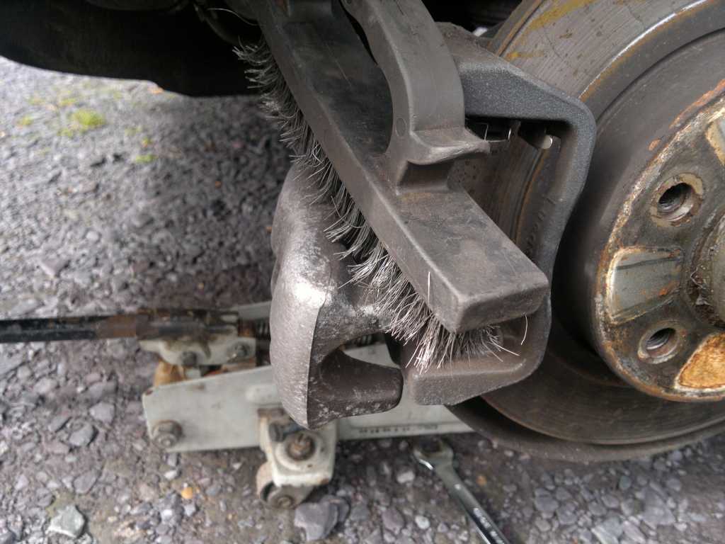

It should look like this -

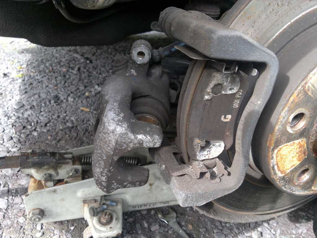

Remove the caliper by undoing the 2 sliding pins, then remove the caliper. Ensure it's supported and does not pull on the brake line

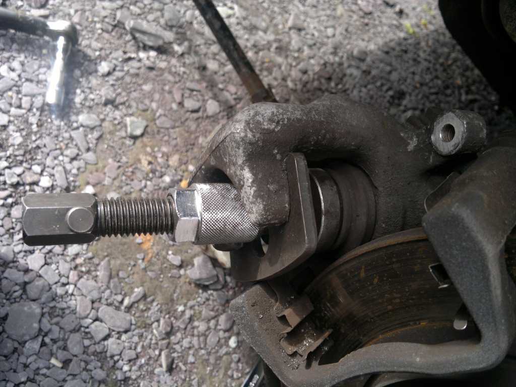

Use the 'wind back tool' to push the piston back in -

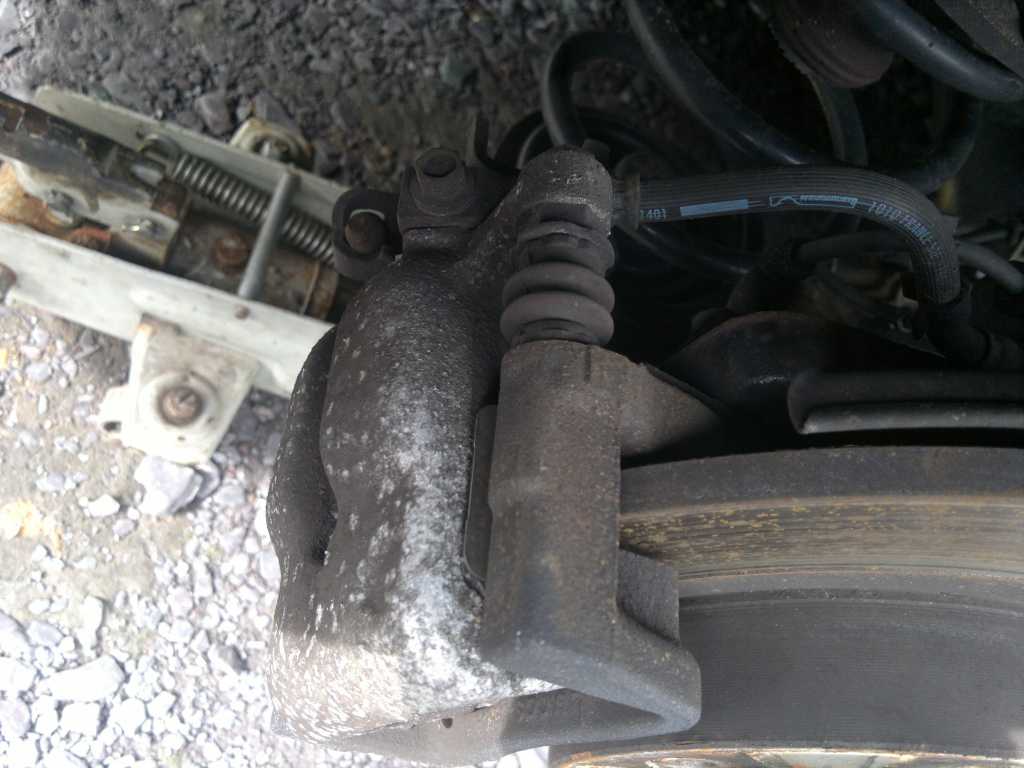

Next, clean all the areas and get as much brake dust off as possible. I also 'Emery clothed' the faces where the pads sit. Ensure the pads move nicely along the holder. Smear a small amount of copper grease on the faces to stop the pads from sticking in one position.
Also grease the sliding pins -

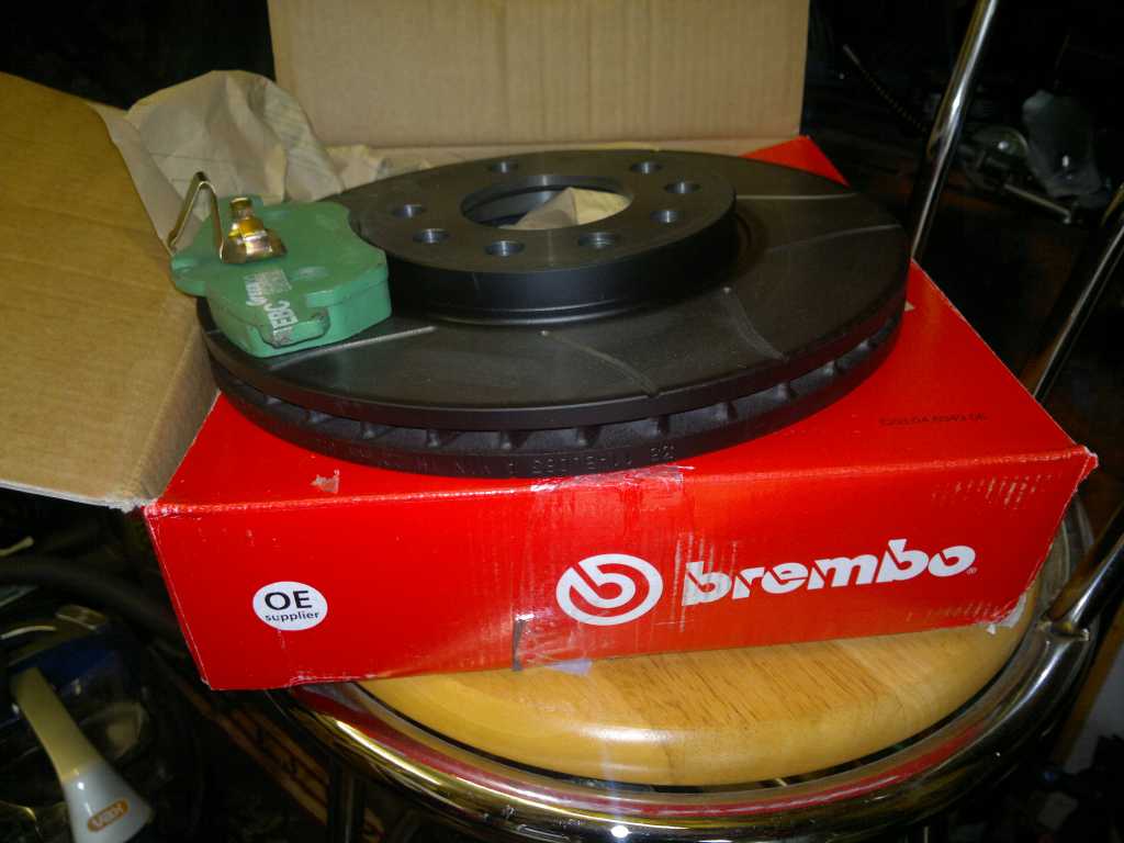

I decided to use 'EBC GREEN' pads with BREMBO max discs -

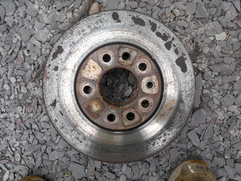

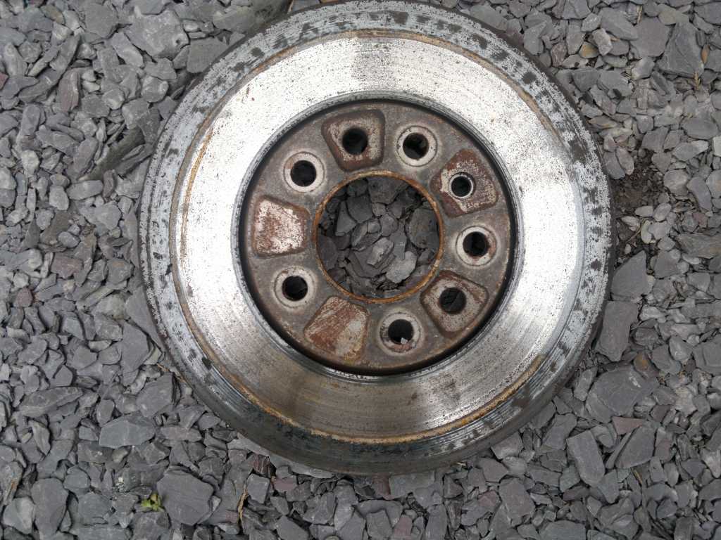

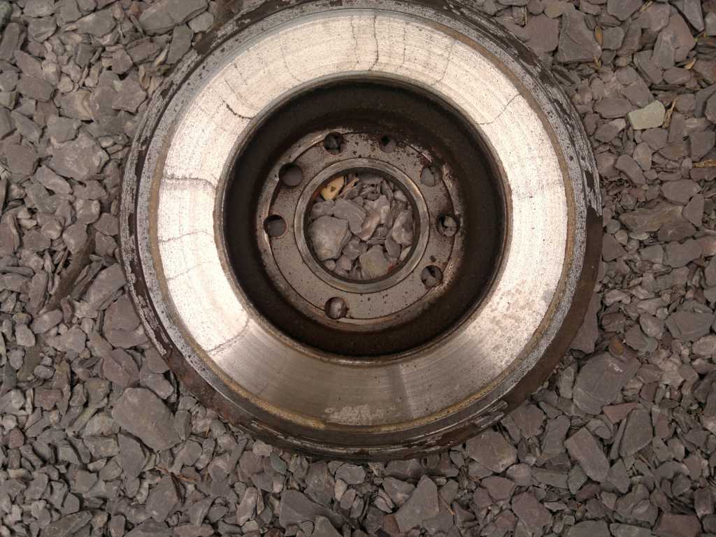

The old discs where worn down to the minimum limit and due to the fact the car had been stood for a while the discs never cleaned up. Here are a few photos of discs that are well past their safe use. You can see the outer edge has corroded. The pads where worn away at that part nearly down to the metal.

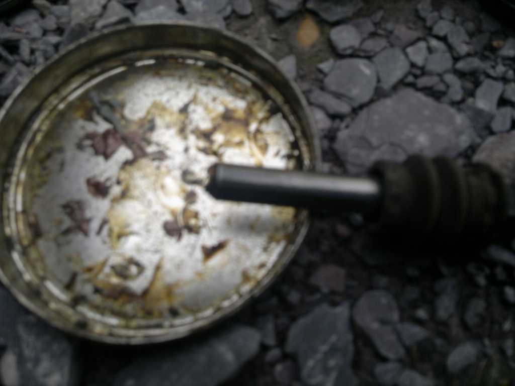

This is the worst as the face of the disc has deteriorated to the point that there are bits of the face missing -
