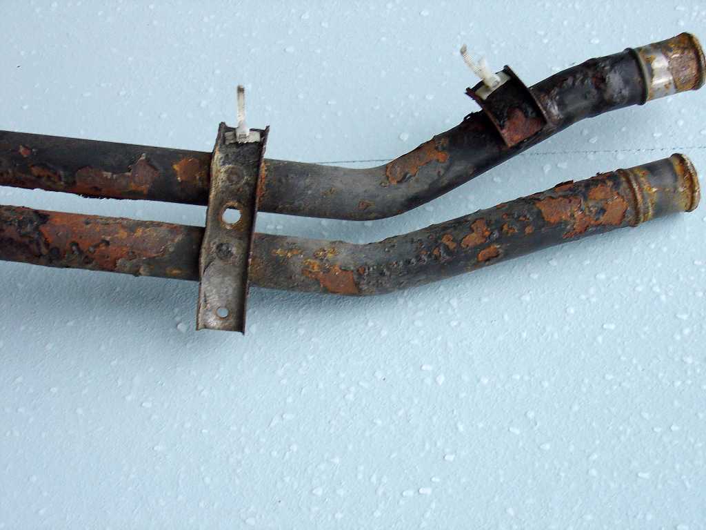

One of the mods really worth doing to your F/TF is to change the underfloor coolant pipes for stainless steel ones. The standard ones are very prone to rust and failure, leading to leaks and possible engine damage/HGF due to lack of coolant.
These were my pipes, and while they hadn't failed, it was only a matter of time looking at them.

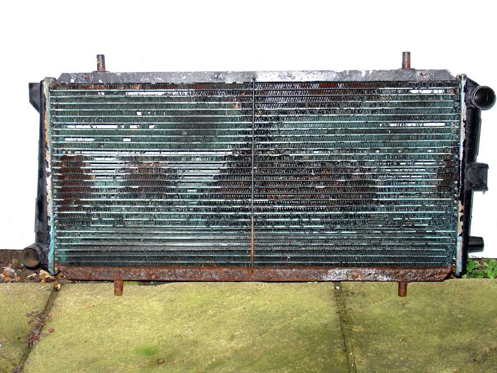

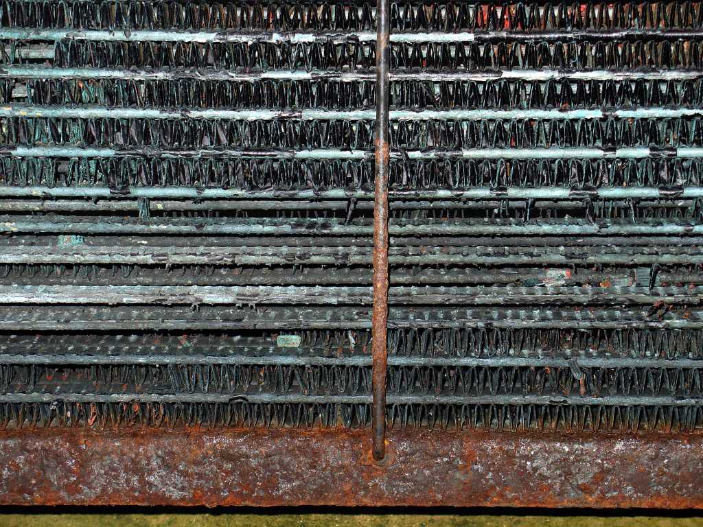

Thanks for this great how to do.While i was doing a oil & filter change i noticed that one of the coolant pipes was dripping a bit so i thought that i would follow your instructions with great photos and change them with stainless ones.Then i looked at the Radiator that was in a bad way as well so thought that i would do that at the same time.With out this great site i would have never attempted any of those things.So i would like to say a big thank you to all you guys who take the time & effort to put these things on here.I have saved a lot of money by doing bits to my old girl,the mgf.& at the same time i have learnt a great deal.Here are some of the photos that will show how bad things were. :ohmy:

They look worse than mine did when I changed them. You'll have to stop driving it in the sea. ;)
Re: Stainless steel underfloor pipes. - How to fit 12 years 5 months ago #30796
Yer i know they were bad i have only had the car for a few months she has done 127,000 i think that most of those were wet winter miles, with lots of salt on the roads,more than whats in the sea i think.
