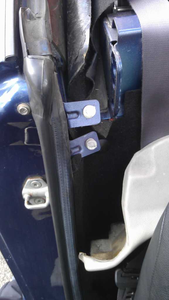

Once the cover is out of the way, you will find a bracket on each side. Each one is held on by 2 13mm bolts.
Undo these bolts
And remove the bolts and plate assembly on each side

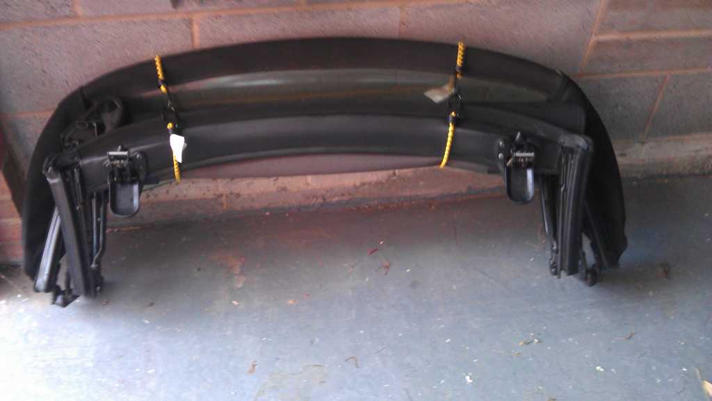

I lifted my screen out of the car using two bungee cords to keep the roof together but you have to have an estimation if you are strong enough to lift it all the way out without damaging paint and I was (just).
The same can be done for the new roof putting back on.
